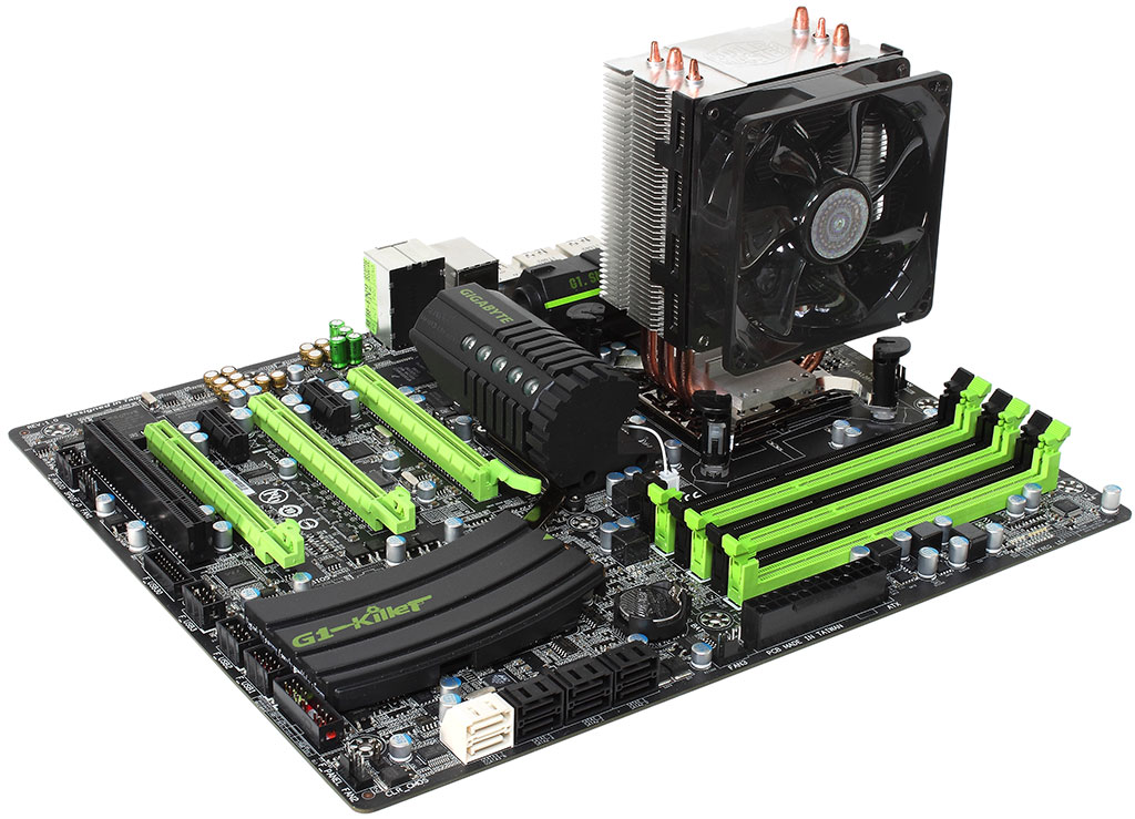

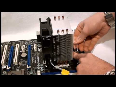

i read that tx3 evo can be munted on original amd clips for cooler, and if i mount it tradicional way it would be like this http://www.youtube.com/watch?v=xYyqe4N1ZT4 but there is another picture i CM's website http://www.coolermaster.com/uploadfile/fileproduct_list/P13021804159d85/PRDPIC/b6686bff3bef45d213e854605411ac43_1361408991.jpg so if i mount like in picture it should be like this http://4.bp.blogspot.com/-1EKqJ7nDO94/ToMPyGzC5lI/AAAAAAAAAQ0/giH-xGqXA40/s1600/126c_tx3evo.jpg with without those brackets and also i readed comment in the same youtube video that i posted saying that "this cooler can also be mounted with fan facing the back of the case you just put the metal clamp through the middle copper pipe to attach it to the AMD back plate" so its going to work that "through heatpipe way" ? and will tx3 evo be better than stock?
It will be better than the stock cooler, the 212 evo is better, but that is still a good cooler. And depending on the backplate you use (Amd vs intel) you can mount it either way. That mounting bracket and backplate should be able to be rotated to be mounted in the other direction. So yes, you should be able to mount it that way.
but mounting on original amd bracket this one http://images.grosbill.com/imagesproduitnew/imagesgallery/BIG/123883.jpg but not that way like this http://i1.ytimg.com/vi/xYyqe4N1ZT4/hqdefault.jpg but this way http://4.bp.blogspot.com/-1EKqJ7nDO94/ToMPyGzC5lI/AAAAAAAAAQ0/giH-xGqXA40/s1600/126c_tx3evo.jpg i seen on tx3 evo website there is lock mechanism pulled thru heatpipe

Thanks for starting this thread, it helped me out a lot. Its not obvious which way to best mount the fan, and its not obvious that you can simply rotate the long spring-like bracket through 90 degree and put it across the opposite way to which the instructional diagrams imply you should! Thanks for everyones answers too.
