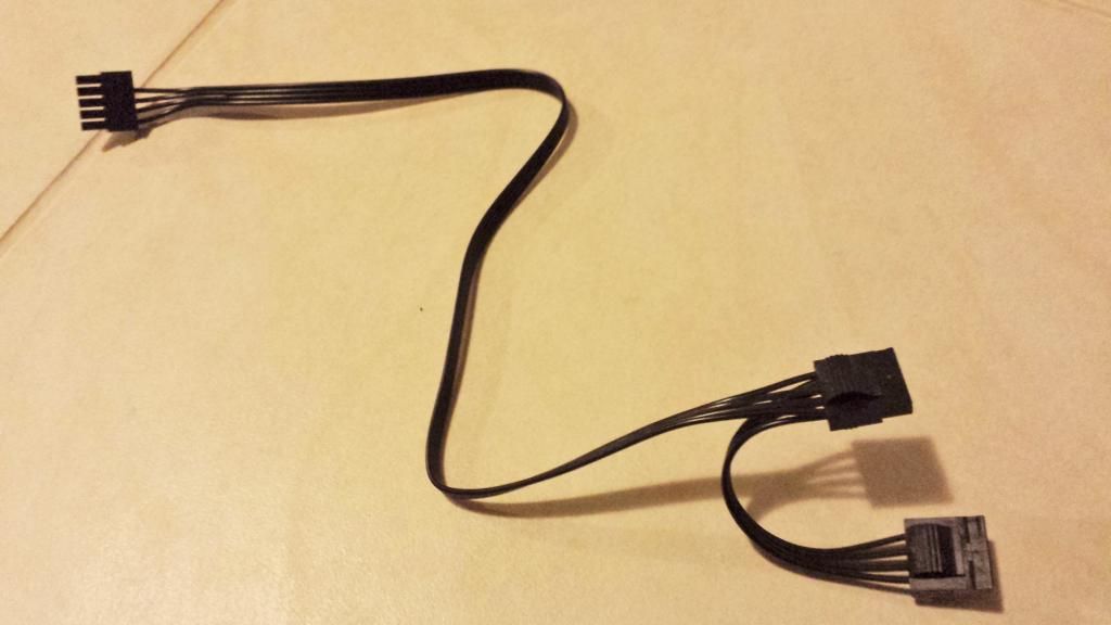

Here's one of the adapters I got with the VGA:
http://i987.photobucket.com/albums/ae351/daniel_mc1982/adapter02_zpsdb27ae47.jpg
I'm currently using the above adapter along with the following cable to power the 6-pin plug on the VGA:
http://i987.photobucket.com/albums/ae351/daniel_mc1982/cable01_zps42f34e87.jpg
Using the above two seems to work for 6-pin video cards. In fact I am currently using it to run my older ASUS card which does not require supplemental power like my new one does.

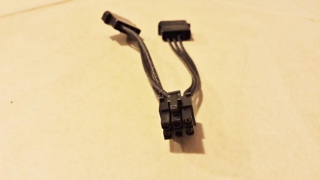

I also got this adapter with the video card but I'm not sure what to do with it. It has a 8-pin on one end and two 6-pin's on the other:
http://i987.photobucket.com/albums/ae351/daniel_mc1982/adapter03_zpsa482d07d.jpg

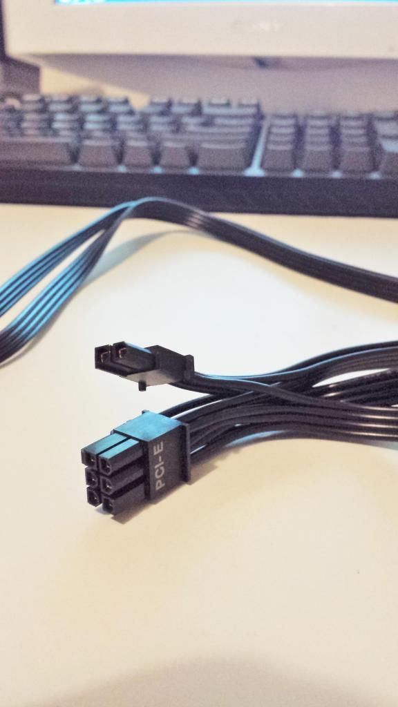

Here's a clearer photo of the 8-pin side, which fits nicely into the graphics card despite being labelled PSU:
http://i987.photobucket.com/albums/ae351/daniel_mc1982/pcie02_zpsced69f95.jpg
(The PSU label is on the other side so you cant see it in the photo)

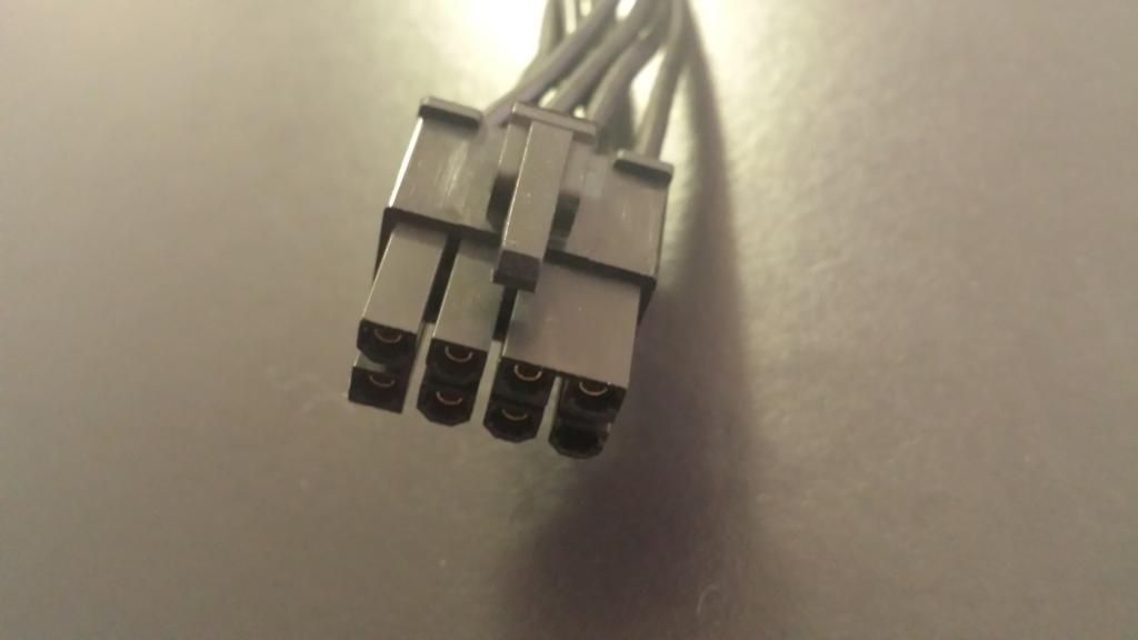

And here's a better photo of the 6+2 (x2) side:
http://i987.photobucket.com/albums/ae351/daniel_mc1982/pcie03_zpse1da054a.jpg
The 8-pin side fits snug on the graphics card so there's really no way I could be plugging that in wrong. On the PSU side I have tried plugging just one of the 6-pin cables in (ignoring the +2) and I've also tried plugging both 6-pins into the PSU (thereby taking up two 6-pin slots on the PSU). Neither of these configurations work and I can't see any other possible configurations with this cable.

Hello Scalli,
You must have received the wrong cables. The 6+2 connection will only connect to the graphics card. You will not connect the 6+2 side of the cable to the PSU. The other end of the cable should be a 6 pin connector. If this end is an 8 pin then please contact us because you will not be able to use this cable with your graphics cards.
