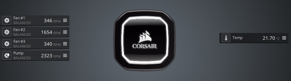

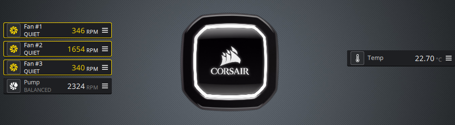

While all the Noctua fans on the radiator are spinning, I can’t seem to control them in the iCUE software. No matter which profile I apply, including custom ones, the fans stay at the following RPM:
Fan 2 is too loud at that RPM. I’d like to set them all to roughly 800-900 rpm.

I can get Fan#1 and Fan#3 to change with custom curves, but absolutely nothing I do will change Fan#2
Any help greatly appreciated!
So all your fans are on the same fan hub? If so, then you're going to be seeing only one Fan's RPM being reported. If you swap connections for the fans on the splitter coming off the pump block, can you single out which header on the splitter is FAN2? You could try with the Corsair fans and see if the results vary. At which point it's possible that maybe the connection wasn't proper. I've recently faced a similar issue with a Phanteks PWM fan hub where the first PWM didn't want to work. Disconnecting it and reconnecting it 3 times, helped alleviate the issue.
Might want to also see if the AIO has any firmware updates.
Lutfij
