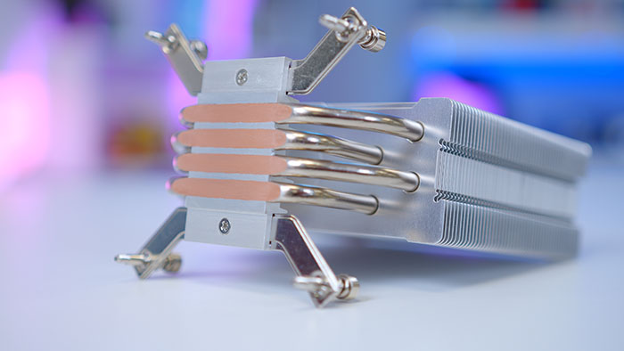

Well if you are willing to spend that much, stepping up to a 120mm tower would probably best for noise and performance in case you ever upgrade the CPU, and there appears to be plenty of room for it in your case.
The usual recommendation for bang-for-the-buck in this category has been for more than 15 years some flavor of Cooler Master Hyper-212. You can see how easy it would be to screw in, and the performance is as good as a Noctua NH-U12S at half the price, but you have to make sure you have 152mm of space between the CPU and side panel.
A slightly shorter alternative with an extra heatpipe is the 148mm tall Vetroo V5. There are actually plenty of good coolers in this category and price range including the be quiet! Pure Rock 2 and Arctic Freezer 34 but those have more loose fiddly bits for installation.
However if you only intend to run a 65w i5 on it, then you don't really need a cooler capable of cooling 150w and a cheapo stock replacement type should be perfectly adequate, plus you've lived with a broken fan for 3 years already. The Cooler Master i70c is basically like your stock heatsink only with a 120mm fan on top.
Reactions: TheDJzodiac
I should point out that the new hotness in bang-for-back is currently the $20 Thermalright Assassin King 120 which is pretty much like the Vetroo, only with a mounting system that definitely requires replacing the backplate (as it has studs instead of holes like your stock one has). So if price is more important than convenience it's also a fine option.
Back when the Hyper-212 was $25, its mounting system was truly terrible with lots of loose parts and requiring three hands or a lot of time to install, so its current higher price could be worth it for the improved mount alone, especially if you can simply unscrew the stock heatsink and directly replace it with this (or the Vetroo), reusing the stock backplate.
