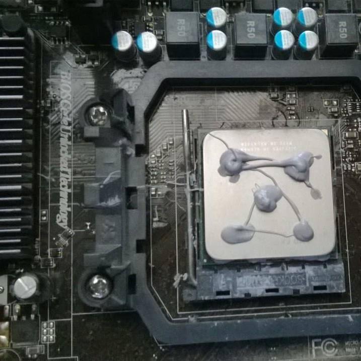

Hmm that would explain why your cpu won't stay cool properly.
This is how you apply thermal paste to a cpu, I do that to amd apus/cpus and intel cpus.
http://i1112.photobucket.com/albums/k481/MaikuGekidouken/4%20dots%20thermal%20grease%20on%20FX6100_zps4h8nimuc.jpg

Its a sure fire bet its not going to cool right at all, I'm surprised your moboa cpu thermal alarm didn't go off when it started peeking at 80 degrees.
Look at my pic and try to do it that way, 4 small dots on each corner of the cpu, gently place it on there and I don't hear from it for the next 6 months. :)
