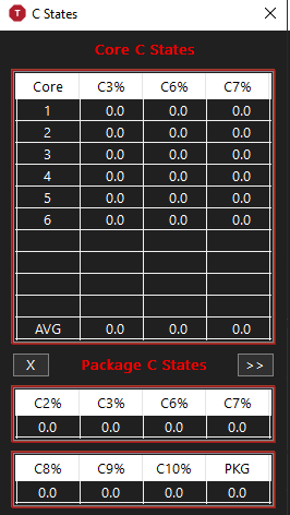

The C states have to be enabled in the BIOS so Intel's locked non K CPUs can use the maximum multiplier. What does the ThrottleStop C States window show when your computer is idle at the desktop?
It is OK for a 1 Thread test to bounce around from core to core. This does not interfere with the maximum multiplier.
What does ThrottleStop show for C0% when idle? Too many background tasks can reduce the maximum multiplier. If any of your screenshots are when idle, your computer is not idle at all.

Either C3, C6 or C7 needs to be enabled so Intel Turbo Boost works correctly. Your BIOS does not give you access to toggle C3 so enabling either C6 or C7 should work. I do not know if C7 or C7s would be better. I would first try only using C6. You should see some higher multipliers during a TS Bench - 1 Thread test after doing this.
I do not think any of C8, C9 or C10 will be used if these are enabled. If you are curious, enable them and see if ThrottleStop reports any C8, C9 or C10 activity when idle. Usually not. Mobile CPUs can use these but most desktop CPUs do not.
