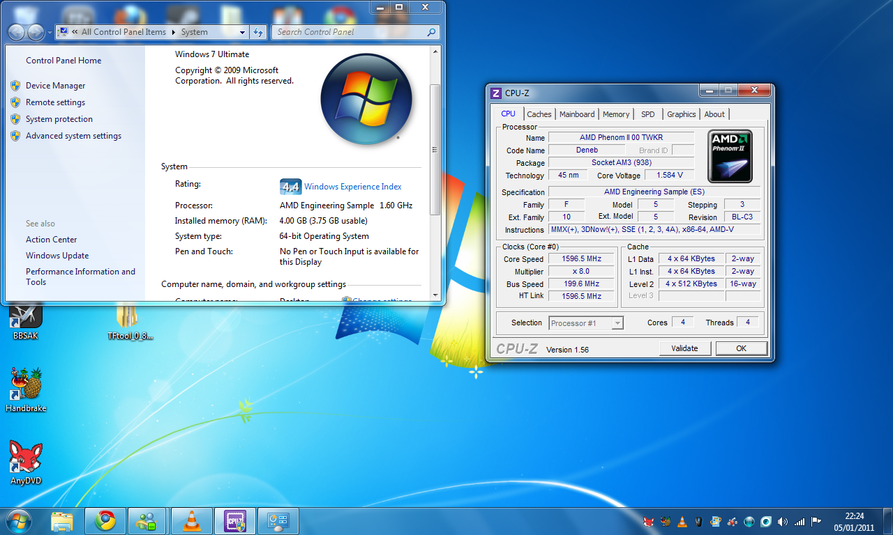

Hi all,
I'm running an Athlon X3 445 Rana unlocked to a 4 core Athlon (showed an a Phemon B45 IIRC) and it has been running fine with no problems. I open system properties and suddenly find it says it's an engineering sample. So I check CPU-Z and that says the same thing, it's a 1.6ghz sample again. I haven't tried rebooting yet and my motherboard is an M3A790GXH.
Any explanation for this strangeness?
Thanks

The CPU was bought in november from ebuyer.com. It was working fine until it did that. It happened after I'd pushed it to 100% which I haven't really done until now.

I doubt it was a glitch because it was stably encoding video at 1.58v and the chip normally runs at 1.4v. Maybe I got lucky and maybe it means I could really push this chip hard with a major overclock. However, it could always be my funky motherboard, they are notoriously unusual as a whole. People have had a lot of problems with them.

Hmmmmm, I think I will email them later, however I just want to ask. Would a normal chip run stably at 1.58 volts without freezing or locking up? Because if not, then this chip must have made it's way to retail from a bin somehow.
I've just rebooted the PC now and it's gone back to the X3 445 that it is, the 4th core has relocked itself.

It automatically set itself to 1.58v, now I rebooted again and it has gone back to a Phenom X4 B45 at 1.4v. It'll probably go back to an Engineering Sample after a reboot. It was an Engineering Sample the last 3 times I booted it. However, the B45 has gone from the name.
I've never tried overclocking it past 3.4ghz but it ran stably then at 1.425v.

Well it clocks down to 1.6ghz with a max multiplier of x8 instead of x15.5 so it becomes noticeably slower than my ULV notebook.
I'd try doing it but I can never be sure what it'll reboot as. I'm leaving it running for now because this time it booted as a real Phenom.

Well I emailed AMD and they didn't want to know so I think it may well be worth giving them a ring and speaking to a real human being. It may be an ES that they assumed would be OK going out as an X3.
I tried overclocking to around 3.8ghz and it worked fine at just over stock voltage for the X3 which is 1.4v, I haven't tried it at 1.55v which the CPU states is the max when it's an ES.
Unfortunately, the CPU has a mind of it's own. It's hit or miss what it will boot as. I will try fiddling with ACC to see if there is a specific combination which works more reliably to have it boot as the ES.
"Stock' voltage is around 1.325v --- 1.4v is the specified 'Max' voltage.
1.58v is too much (unless you are under DIce or LN2).
When you 'unlock' an AMD processor you bork the system readings, sensors and ID. AMD sold the CPU as an X3 445 and you have claimed:
... I tried overclocking to around 3.8ghz and it worked fine at just over stock voltage for the X3
So what's the issue here, again?
