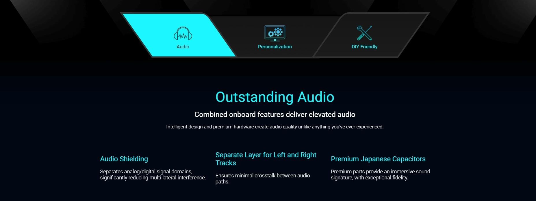

Thank you very much for your advice.
Unfortunately, after I unplug the HD audio cable from the motherboard, the static noise is still there. There was no improvement at all.
So, that rules out the cable interference?
Maybe something's wrong with my graphics card? But it was fine before the upgrade, same as the PSU.
I still believe my motherboard is defective somehow, though ASUS promoted it by saying:
