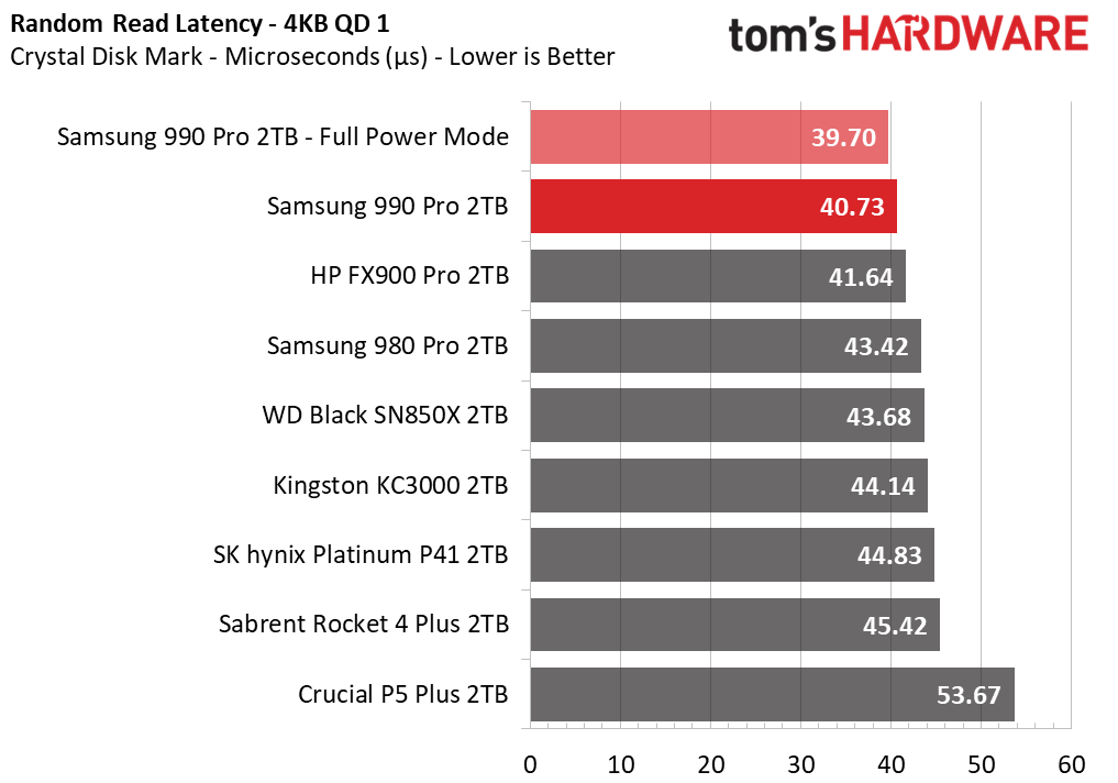

Perhaps more importantly, there's less than 13 microseconds of read latency, a huge reduction compared to the ~50 – 100 µs for 3D TLC NAND, and 4 µs write latency, another massive decrease compared to ~200 – 400 µs for 3D TLC NAND
Your range for read latency is skewed a little high. The best PCIe 4.0 drives dipped just below 40 microseconds. I think we've seen even lower, for PCIe 5.0 drives.
Source: https://www.tomshardware.com/reviews/samsung-990-pro-ssd-review/2
