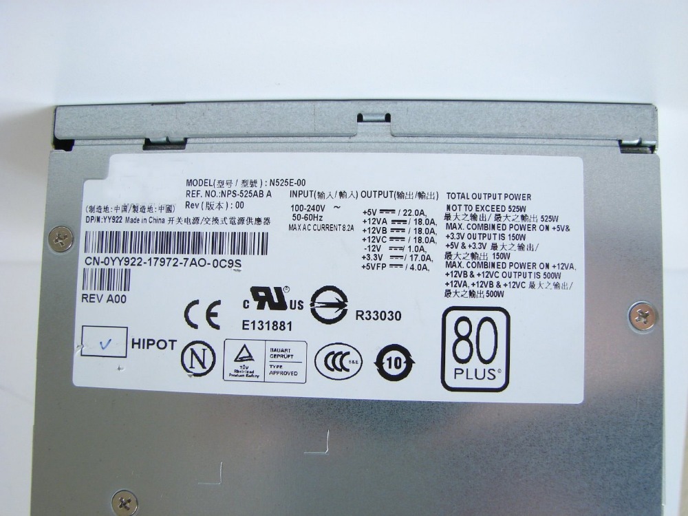

If this is the nameplate on your PSU: http://g02.a.alicdn.com/kf/HTB1MZTdIVXXXXa5XVXXq6xXFXXXs/Original-YY922-525W-Power-Supply-N525E-00-for-Dell-Precision-390-T3400-T5400.jpg
It has enough power for the GTX 750 Ti, HD-7750, and the R7-360 as it is. You would have to use a 6-pin adapter for the R7-360, but with a +12v rail rated for 500W, you are fine.
But to answer your question, yes the PSU is a std. ATX.
The HD-7750 uses a conventional legacy BIOS, so it should work for sure. The R7-360 may use a UEFI BIOS, not sure. I know the R7-370 I used to have does. But of course, the GTX 750 Ti is the fastest of all three.
