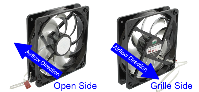

Yeah, most fans blow out the side with the bracing. Took me a while to realize that.

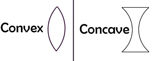

For the op just to follow on, the convex side of the fan is intake -> ( and concave (the inner fan) is output -> )
You could revert any fan to face the same way if the wires could reach and out of harms way. The bracing jwcrellin mentioned is where the motor and wires originate from so to reverse an intake fan would mean the wires would be outside the case :)
Can see here all intake/exhaust fans are all facing convex
