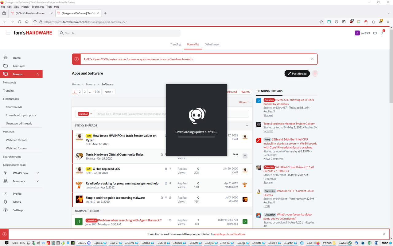

Question Discord stuck in downloading update 1 of 15 and won't open ?

I downloaded Discord at Discord website.
Ralston18
Try a fresh download and reinstall.
Do so manually. No third party tools or installers.
Look in Reliability History/Monitor and Event Viewer.
Hopefully either one or both tools will be capturing some error code, warning, or information event just before or at the time of the update failures.
Reliability History is easier to use and understand. The timeline may reveal some pattern to the failures.
Event Viewer requires more time and effort to navigate and understand.

There are no special things with Reliability History/Monitor:
I didn't find any Discord-related events in the Event Viewer.
This problem began yesterday.
