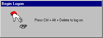

OLED burn-in is logically no different than Plasma or CRT, since they use pretty much the same phosphors, just lit using different technologies. And I don't know about you, but the only Plasma burn-in I've ever seen is the sports channel chyron burned onto TVs in a sports bar, or on CRTs the Win NT login screen. So burn-in really shouldn't be an issue in normal use unless you turn the brightness up way too high to say, compensate for a daylit room (which is exactly where LCDs would excel and their lack of really dark blacks would be least noticeable). Yes, if you abuse the heck out of it, burn-in will show up relatively quickly, as not only is it dimmer there, the color shifts because blue is the least durable. But I use OLED as a PC monitor, with a fixed taskbar even and no issues--because I turned the brightness way down as is appropriate for the technology.
LCD uses the same phosphors too, whether in their fluorescent or white LED backlighting, but there burn-in can't be an issue as the whole screen goes dim evenly all at the same time (sure, the color may shift too but again, the whole screen at once). Unless it's local-dimming LED, where I suppose oddly block-shaped areas could go dimmer or different colors than others with age.

Did you ever have burn-in on Plasma or CRT? The Win NT login screen example I gave was powered-on with a bright static image for at least 16hrs/day after work hours, and 24hrs/day weekends so 6,656 hours per year or over 50,000hrs over ~8 years, since this was before sleep modes + software like screen savers didn't work when not logged in. They were used 8hrs/day on weekdays so up to 16,000hrs of mixed PC use over that time (mind you could've had less use per day for lunch) with bright desktop icons and gray taskbar, but the only visible burned-in image was
which was clear enough to read the text.
For office use monitors have to be turned up pretty bright, but at home just control the environment + turn the brightness down and there should be no issues.
