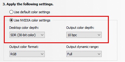

10/12bit on SDR is not supported on consumer cards..i mean color is capped to 24bit (8bit single base color+8bit transparency), even if you set it to 10/12bit pixel output, it would look exactly same as an 8bit pixel output
this feature (properly supported) is available on workstation GPUs like nvidia quadro or amd radeon pro/fire pro
and in nvidia color settings its looks like this:
so the 10/12bit pixel output is limited to just HDR content (more colors), but as i mentioned earlier your panel is physicaly not capable to show more than 10bit (1B colors), so 10/12 bit would look exactly same, just it would use more bandwith and GPU would work slightly harder for no picture quality enhancement
