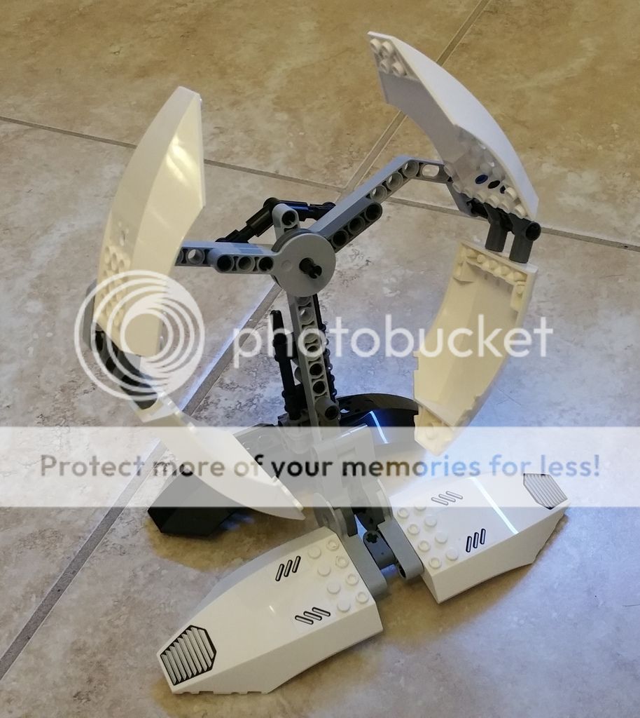

I am working on a DIY Lego desk fan and for the life of me, I cannot find a fan that exhausts on the opposite side of the label and support struts. In a PC, I'd normally just flip the fan around. However, here I don't want the label and wires facing the direction of the airflow....it is unsightly. Does anyone know of a 120mm fan that intakes from the support strut side and exhausts air out of the open end of the fan?
Edit: Adding images.
Here is what I built. It's just for fun, but without a fan the moves air the opposite direction, this design wont work.
http://i375.photobucket.com/albums/oo198/Tien223/base_zpsrzcattlm.jpg
This is what I want it to look like:
http://i375.photobucket.com/albums/oo198/Tien223/wantedfan_zpsa3u4cmre.jpg
However, to move the air forward, the fan has to be turned the opposite way and it cannot be affixed with this design. This is not what I want:
http://i375.photobucket.com/albums/oo198/Tien223/dontWant_zpstvz9ljdu.jpg

I read that you can't really reverse the direction of PC fans as they circuitry prevents this. I also know the blades are optimized for one direction so I'll lose airflow. That's what I have read at least. Im hoping that some one has found a fan, preferably with white blades, that pushes air out so you dont have to see the support struts and cables. I'd post pics but it looks like I have to set up an image hosting account on another page? Fit this project, I mount the fan unless the strut side is the intake side. The exhaust needs to be open.

Thanks! I just edited my original post to include image links. I am looking at the Artic Cooling fans and they might work. It's tough to tell the airflow without physically seeing it. Do all CPU fans push air into the CPU heat sink?
