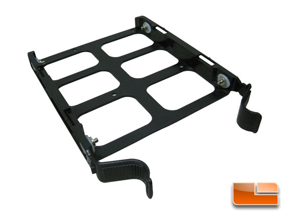

2| You could use sleds/drive caddy's off of other cases if their design(s) match that found in yoru case. One example is this drive caddy found on a 500R
All corsair cases will have a near similar caddy style but it will not be the same for another brand of cases. You're going to have to contact CyberpowerPC in order to perform the HDD upgrade since they hold the keys to that door. On top of that, you can't tamper with the innards since that will void your warranty. and it also looks like the system is brand new.
1| HDD sleds are a form of rail that help guide a HDD into a drive cage/caddy. like so:
