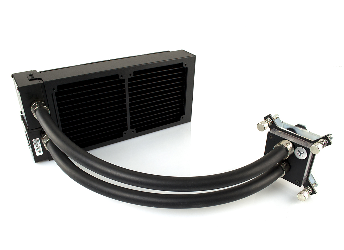

I am using water cooler for my CPU so I know I need a pump and fans for it. Now I am facing the same problem for a waterblocked graphics card (nVidia GeForce GTX TITAN). The item for sale is just the graphics card having waterblock and radiator attached. Do I need to purchase an extra liquid pump and fans to make the card work under normal condition, like the picture shown below?

From the image it looks like you will need a pump, tubing, water, fans and the radiator.

You got the heat sink on the card. Attach tubes, that run to the pump and radiator, and fill the system with coolant (water). Plug in the pump, attach fans to the radiator and you are good to go.
The picture in your first post from 08:07 looks like a 240mm all in one processor cooler from EK water blocks. In all in one systems the pump is integrated into the heatsink or the radiator. Such closed loops are not meant for extension.
If you want to water cool both your cpu and gpu in the same loop you have to build it yourself, or look for an open loop AIO such as the Alhpacool Eisbaer product line!

Are you sure it is an "all-in-one" water block? I studied an "all-in-one" water block product here and found that there should be two pipes already connected to the radiator, but there are no such existing pipes in the picture -- only two holes waiting for me spending more money to fill it. So are you sure it is an "all-in-one" water block?

I referred to the picture in the post from zzzhhh dated 16 May 2018 08:07:08
If the fittings at the end of the tubes are removable, than you can extend the system, and I admit my assumption was wrong. If they are sealed, you will have a hard time connecting other components to it.
