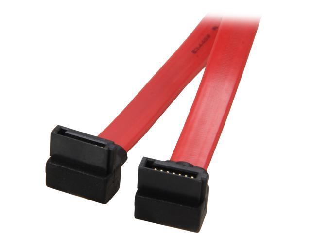

When you power up, can you cycle (open/close) the DVD door. If NOT check the power cable. elbert picture is the SATA Data cable. There should be two cables connected to the DVD drive. also Make sure you plug them in correctly. Note the "Notch at one end of the cables. While they should NOT go one the wrong way, they can be forced on
