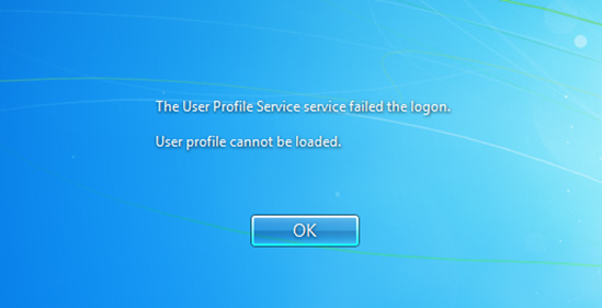

everything reseted, but my harddisk. this have happend before, but this time i dont have savepoint to go back to...
every program is reseted. chrome, windows settings, itunes and all my games. even my background is set to black, and my folders and programs icons are gone.

As said above, most likely a corrupted profile causing a temporary profile to be created on each login. See the following link for how to proceed:

All of which does absolutely nothing to fix a corrupted profile. Create a new profile and transfer what can be transferred from the old one is the only thing that can be done in this case.
