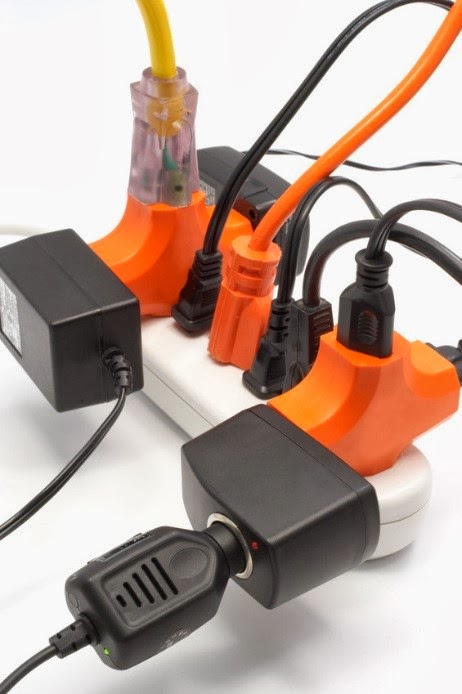

Again, if it's not using cheapo dollarstore extension cables and not trying to run everything in the home off one outlet, you should be fine.
A single powerstrip that is rated for your workload and isn't exceeding the outlet's limits is fine.
This is fine:
This is... ok:
This is bad:
This is really bad:
This... just.... never:
