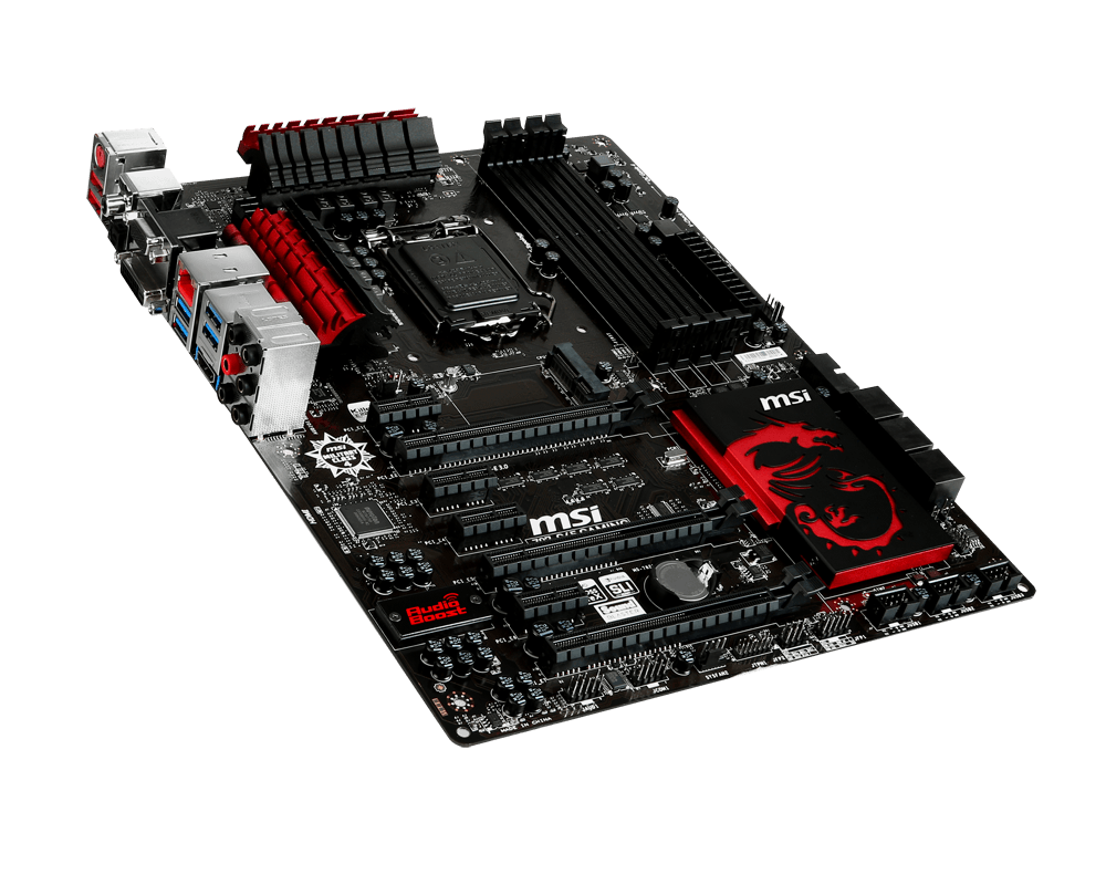

This is my motherboard: LINK. I don't have a power on button like this motherboard: LINK. What do I do?

1. What is the big square on this motherboard that says MSI on it?
2. Where exactly can I touch to handle the motherboard? Is it safe for me to place it upside down to install the CPU cooler brackets?
if you want to boot the mb you connect the 24 and 4/8 pin power from the power supply. on the mb case header pins look for the two in the mb guild that say power switch. the easy way is put a jumper on the pins and then turn the power supply on or off or short the two pins with a screw driver. hold the mb by the edge dont flex it. the msi logo for heat sink for under the mb chipset or vrm (voltage regulators). you can flip the mb over make sure you dont drop it or slide a screw driver over the cpu slot and rip something off.
1) There are pin headers to attach the power button to from the case. The second motherboard has it there just as a convience. 99% of boards do NOT have an power button like that
2) its a heat sink to cool down the south bridge
3) you can pretty much touch any piece as long as you are not staticaly charged. Touch some metal somewhere else or wear a grounding bracelet. Just don't break anything off while handling it.

1) "MSI" stands for the motherboard manufacturer. Depending on where it is depends on what it is. In other words it could be multiple things.
