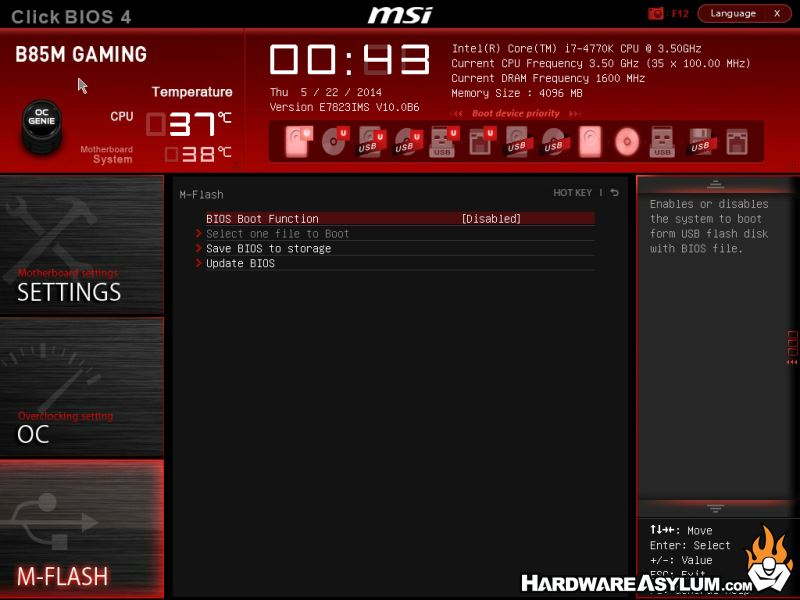

Screens would be similar to this:

I enabled the BIOS Boot Function. Then it asked to restart. I don't think it asked for which file. It just asked to restart after I enabled it.
there wasn't any progress indicator, it just asked me to restart
