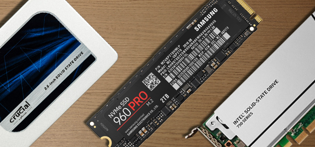

SATA= the cable connection your ssd has with the motherboard
NVME - New type of ssd, goes on motherboard instead of in a box like ssd, can be up to 5x faster but also run warmer, Wouldn't be ideal in that case.

I think my SSD is NVME. Somewhere in browsing around today gathering info I saw NVME (maybe it was in HWiNFO), so I think it is that type.

Inland Pro 2.5" SATA III 6Gb/s
if it goes in the back slots its just a normal ssd.
https://www.amazon.com/Inland-Professional-512GB-Internal-Solid/dp/B088KLZKPQ

More info regarding the SSD: It is in the slots that I think you're calling the back. In this pic
you can see it (the green label). Anyway, it's definitely not on the motherboard, so I guess that means it's not the newer, but hotter kind.
