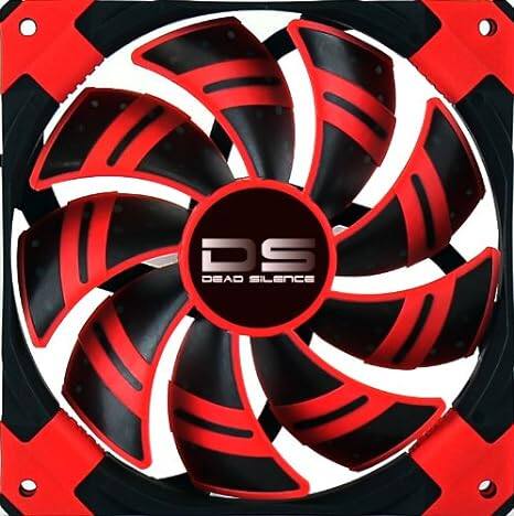

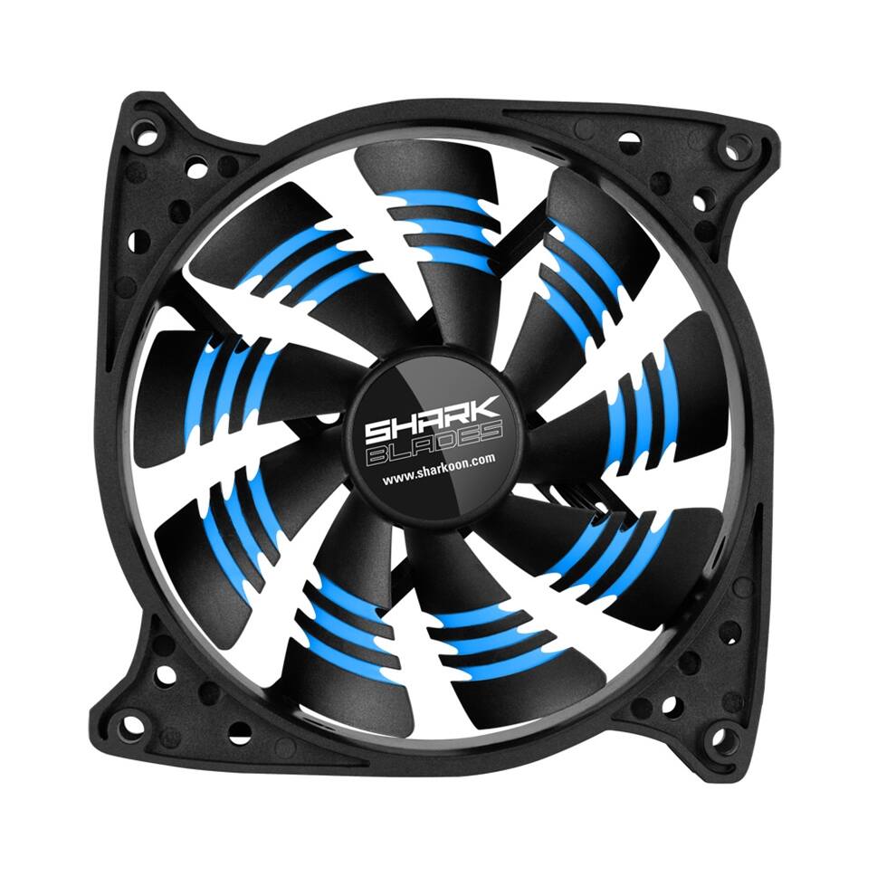

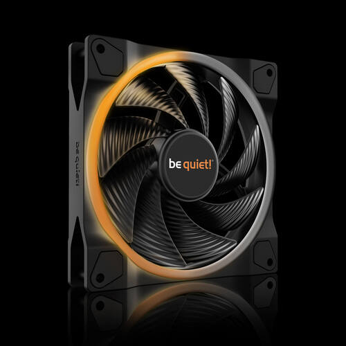

      3. Airflow and sound control: These design modifications attempt to direct the air, and/or reduce noise, and can look like protrusions, indentations, slots or even teeth on the fan's blades and/or frame.
        Aerocool Dead Silence
        Sharkoon Shark BladesXigmatek XAF-F1253Fractal Design Dynamic X2 GP-12DeepCool TF 140S
        be quiet! Light Wings

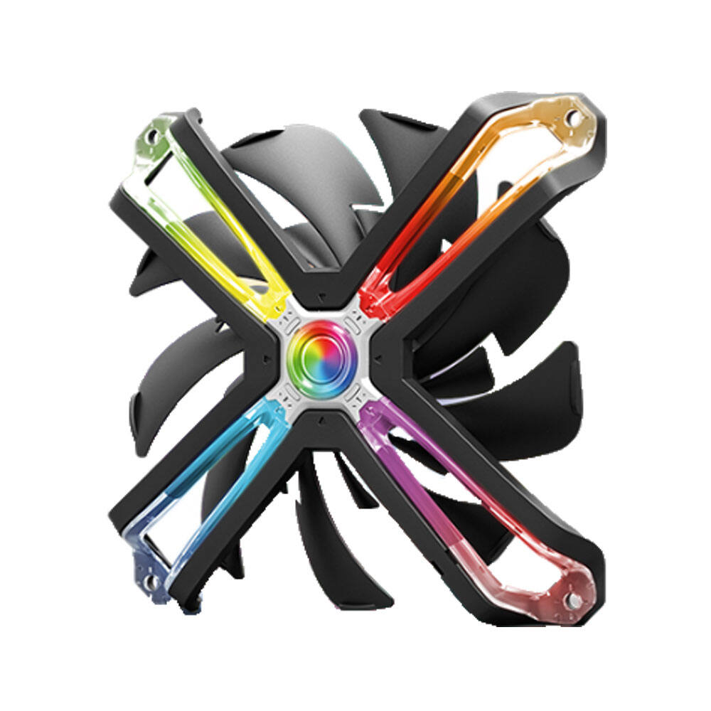

    4. More lights: Some manufacturers have now taken to including embedding LED lighting in the frames. This can be especially appealing for some. Also, the number of LEDs in a fan can play an important role in the appeal, as can zoning, position and concealment.
