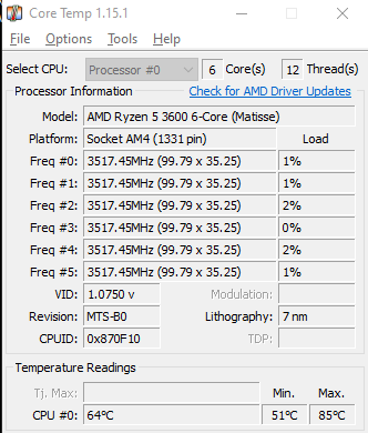

According to core temp, the temp is sitting around 60c for CPU, but has hit a max of 85c, which is very high, I normally play Assassin's Creed Valhalla at 71c. 85c is something I've NEVER seen before, 80c is the absolute highest I've ever seen it.
But 85c happened BEFORE I opened the game. Opening the game somehow made it drop in temp, which makes NO sense at all to me...
