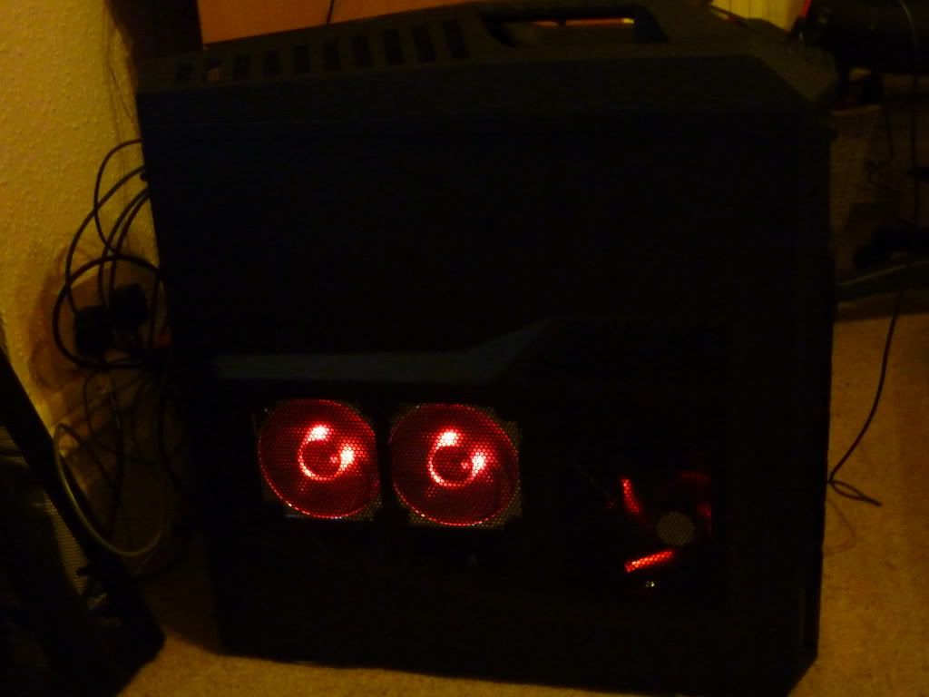

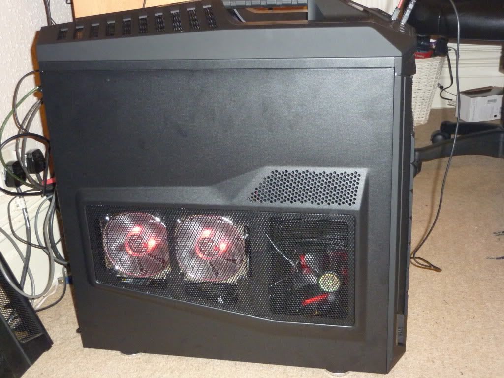

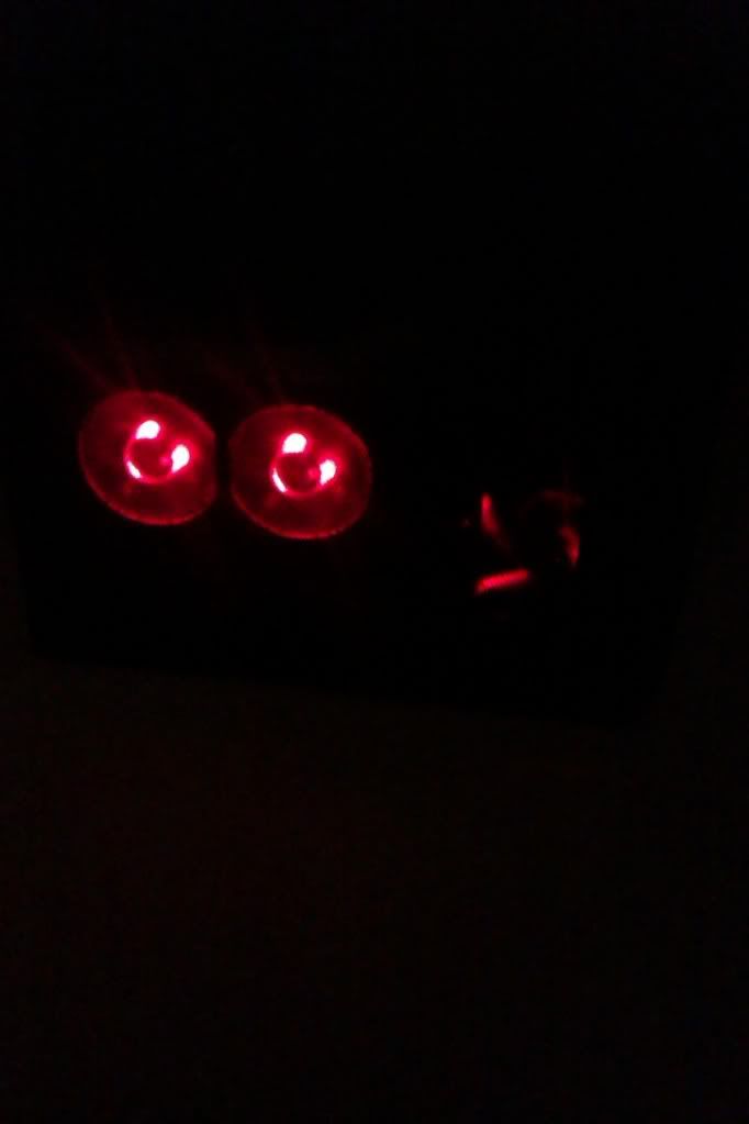

though if you want good led fans then i would go for these--they give a much better light than the
coolermasters because the leds are in the hub not the frame
http://www.scan.co.uk/products/120mm-silverstone-sst-ap121-bl-air-penetrator-1500rpm-fdb-blue-led-fan
the coolermasters tend to give lines of light--these give a full circle
heres my new build with 2 of these on the left and the coolermaster fan on the right
http://i1184.photobucket.com/albums/z330/mcnumpty23/stormtrooper3.jpg
http://i1184.photobucket.com/albums/z330/mcnumpty23/stormtrooper2.jpg
http://i1184.photobucket.com/albums/z330/mcnumpty23/airpenetrator120mmred1.jpg
not a great photo as i only had my phone handy but should clearly show the difference
