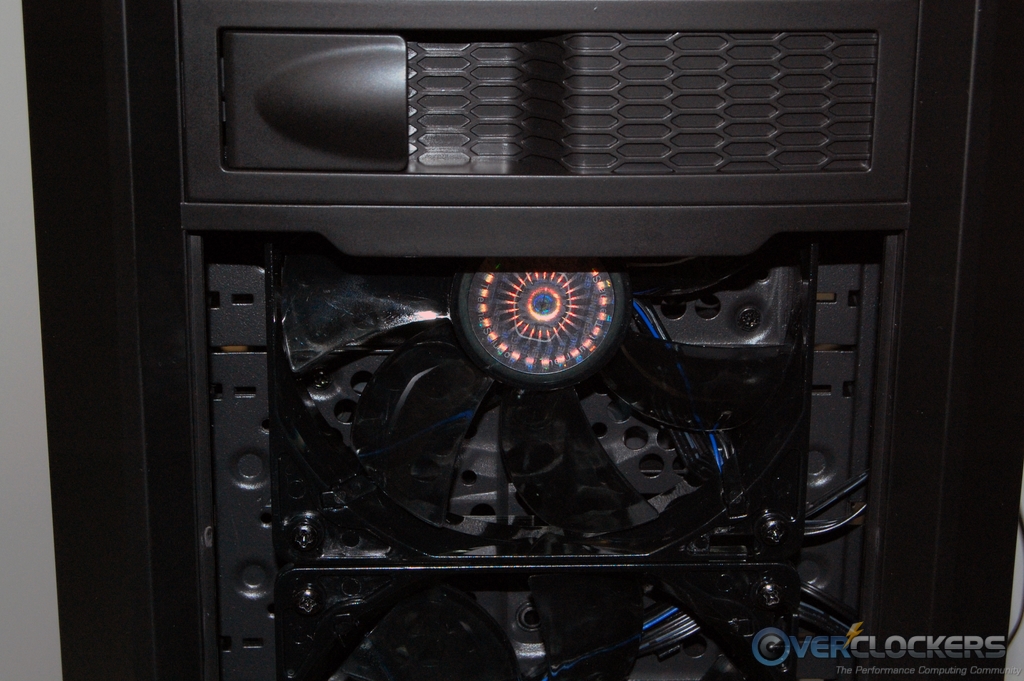

Hey guys, i know this is somewhat of an old thread but i recently bought a bunch of quiet fans with white led's to install two in the front, and two in the top. I simply took some pliers and bend away the little rim sticking out on the bottom of the front fan plate mount. it allows you to move both fans down, so that you aren't covering any 5.25 bays. Hope this helps!!
MacManDeluxe
Jan 29, 2015
4,510
Do you have pictures of what you did? I'm not quite sure what you mean. Thanks!
