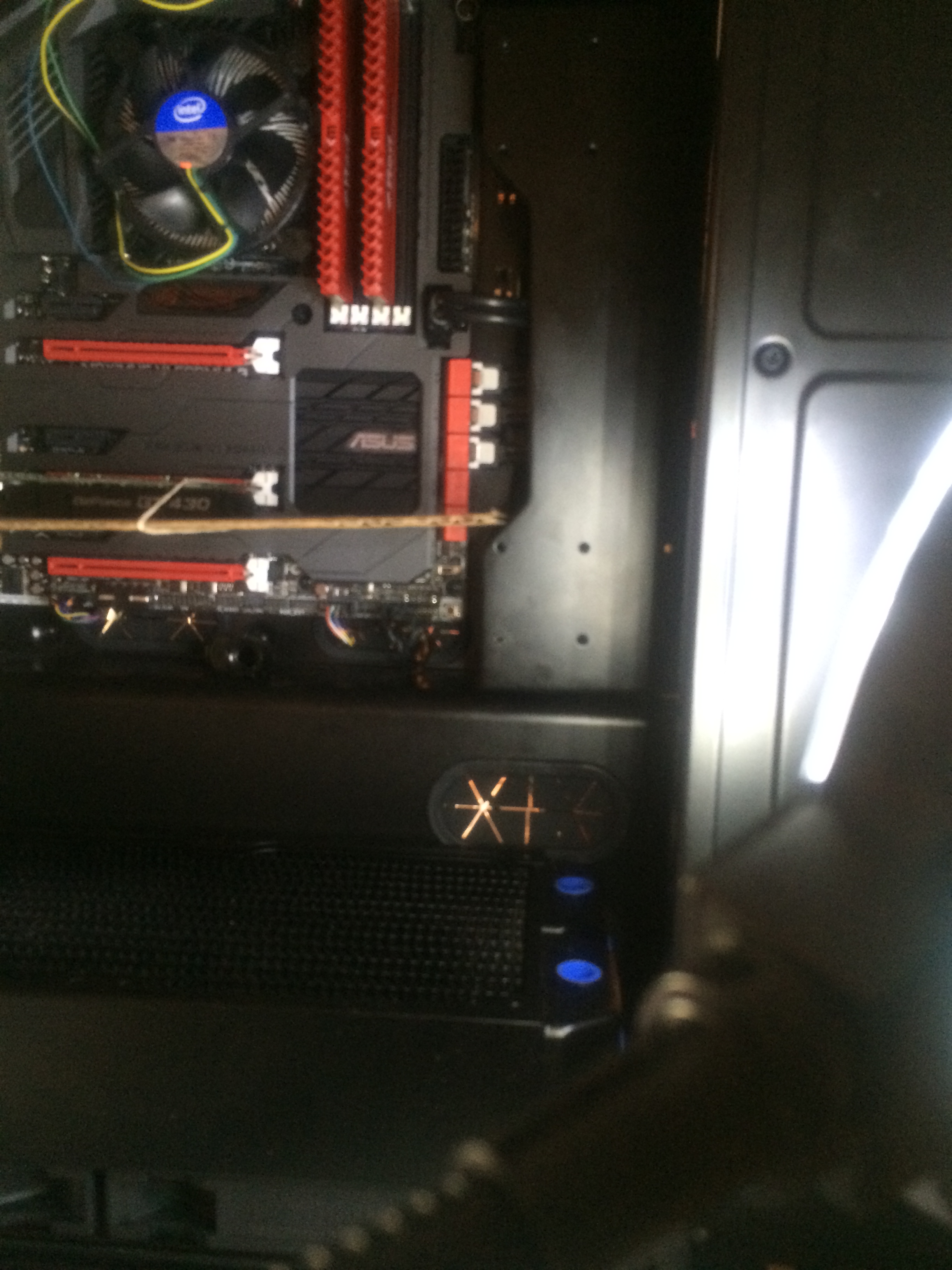

OK so I have a enthoo primo with a Asus maximus formula vii and a Intel i7 4790k I would like to cool so that I can begin overclocking.
I have never run a custom loop and I am a bit unsure about part compatibility etc. I have done some reading on the subject and come up with part of my shopping list.
I wish to expand this loop in the future to overclock some graphics cards so I have gone fore a dual loop. Probably more trouble than it is worth but it seems like a nice idea.
For now each loop will cool a different part the motherboard and the CPU then in the future the motherboard and some GPUs.
If someone could give my shopping list a quick look that would be great.
Also if you know of any good guides to picking parts and setting up that would be great. I do not know many people interested in this lucky them because I would be picking their brain on this topic.
I hope this is not to noobish as this probably gets asked a lot but any opinions would be great.

doesnt look to bad, I wouldnt use the ek pastel liquid I havent heard good things about it if i remember correctly.
also you really dont need to cool you mobo, its nice but isnt really needed.
a nice single loop even with your gpus will be a much better idea in my eyes.
the lrt tubing is some of the best you can buy,that is what i run and it wont break down after a while.
Your going to what at least a 240mm or 2x120mm radiator for your cpu. I would only use a single 120mm radiator if your going to keep the cpu at stock speeds.
Compression fittings are fine just make sure you get a good bite on them, wiggle the hose around to make sure its not going to come loose. I always stuck with the good old barb and hose clamp
Don't use dyes in the coolant, they will stain the tubing, reservoir, and blocks. Learned this the hard way with one of my builds. If you want color then get colored tubing.
hes got 1 120 and 1 480 overkill for now even if he does add a single gpu to it
yeah I see it know, just kinda did a quick read through on the list
Ok good idea with the dye i thought it would look cool but thinking it just adds more cost. :)
And yes the 120 is for the motherboard its there to be cooled so I thought I may as well. And the cover on the board does not exactly help keep it cool i have noticed.
With the barbed fittings I'm just so worried I will mess one up. Peace of mind i suppose.
both fittings are fine, compression are much more expensive but are much easier to remove the tubing from than the barbed.
the barbed you really need to heat them
what are your mobo temps like?
ohh and dont forget to add a spot at the bottom of your loop to drain, will save you time when refilling
