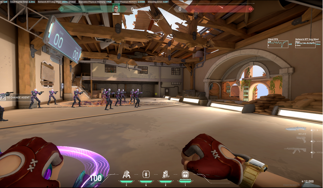

Example of behavior (Note I've replicated in 4 games including one offline game):
The behavior only shows up every 3-5min give or take and I suspect it's CPU/RAM related at this point. So I would need a CPU dependent benchmark that runs for, say, 10min to test. I've also tried to replicate in Furmark but I can't seem to replicate there.
