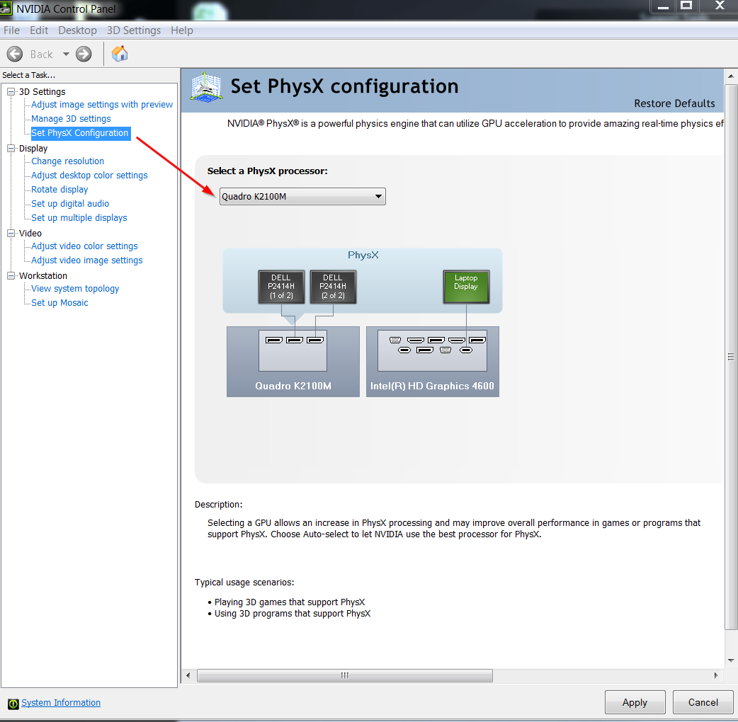

id guess monitor outputs are wired internaly through integrated gpu (amd) and not nvidia
you can confirm it once you click in nvidia control panel on "configure surround ,physics", there you will see which video outputs are wired to which GPU
example image:
0EM30000000UYaF
u cant change it in settings, its physicaly wired
in that case you would need to enable freesync in amd display settings
