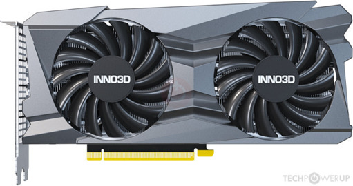

Hey guys recently I brought brand new RTX 3060 Twin X2 12GB and getting 85 degrees while playing games on ultra settings.Is it normal?
