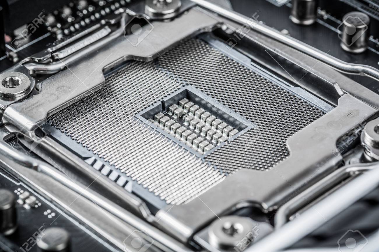

People online said "bent pin" for the CPU but this CPU had no pins to bend, the CPU is a 2001-v3 socket Core i7-6800K that just had little dimples where it connected to the socket.

They are correct mentioning bent pins however, the pins they are referring to are located in the MB CPU socket and if any pins are bent then that can cause your issue.

It can only be the CPU and you may have bent pins in the MB socket. Can't remember but did you check the MB socket for bent pins.?

Yup, you got it spot on. The processor doesn't have pins. It has these little nibs. The "pins" are on the motherboard itself but even then they're not really pins. They just are little depressions. I have taken it all the way out and re-set it. I also took it out to send in the motherboard and put it all back together.

btw: What the MB socket has are pins and if ANY are out of alignment or flattened down can be an issue. If you have bent any you would void your Warranty as that is considered user error, so be mind-full of that. If you do have any bent, they can be aligned or lifted back up using a toothpick. The socket should be inspected with a magnifying glass.

There is nothing that can be out of alignment on the pins. This is what the bottom of the processor looks like (not my picture) http://images.anandtech.com/doci/10337/3_678x452.jpg
This is what the socket looks like: http://previews.123rf.com/images/cookelma/cookelma1409/cookelma140900109/31825724-Modern-socket-2011-v3-motherboard-for-a-home-computer-Stock-Photo.jpg (not my picture)
I inspected it thoroughly and it is good and clean, no issues. Also the motherboard MFG when they took back the motherboard would have checked that.
