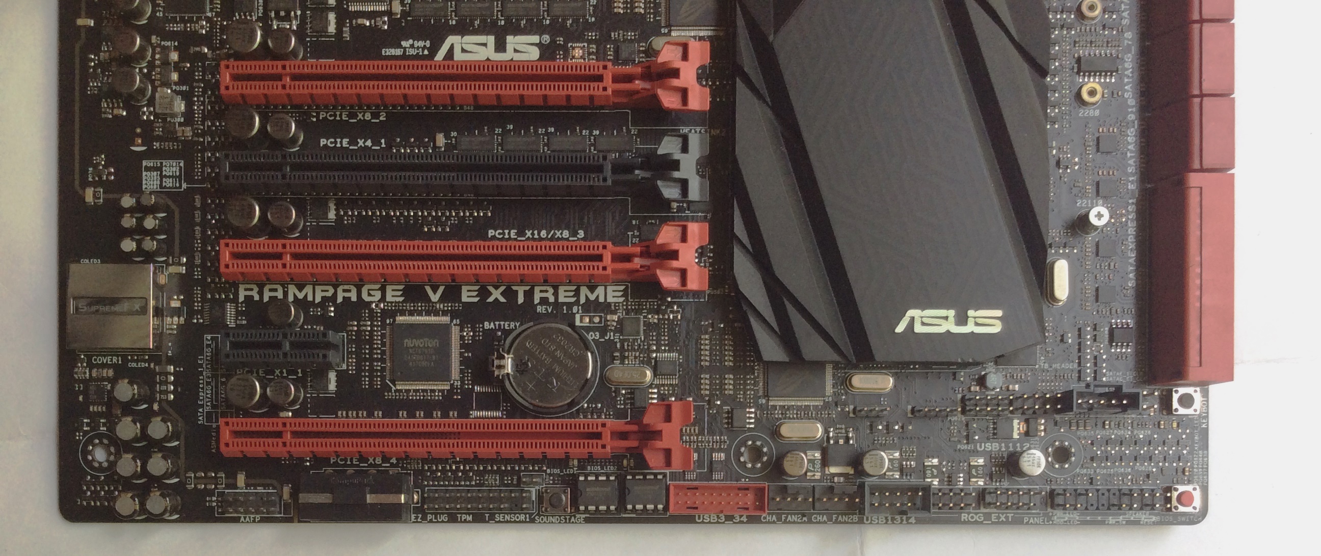

The board you're referring to is this
while the temperature sensor you're talking about is this
Which are essentially two pins extruded from the motherboard/PCB and will only contain two pins to connect to a thermal coupling.
You're going to need to have something like a T_SENSOR1
on your board.
You could invest in a fan controller that accepts thermal probes to it.
on your board.
Thank you for the response. You're correct, that is the board I'm referring to, and provided a link for.
I'm not seeing a T_SENSOR header at all on this board, so I don't believe that it will support the Bitspower Temperature Sensor Stop Fitting. I'm not keen on installing a third party fan controller, and can live without the temp reading.
