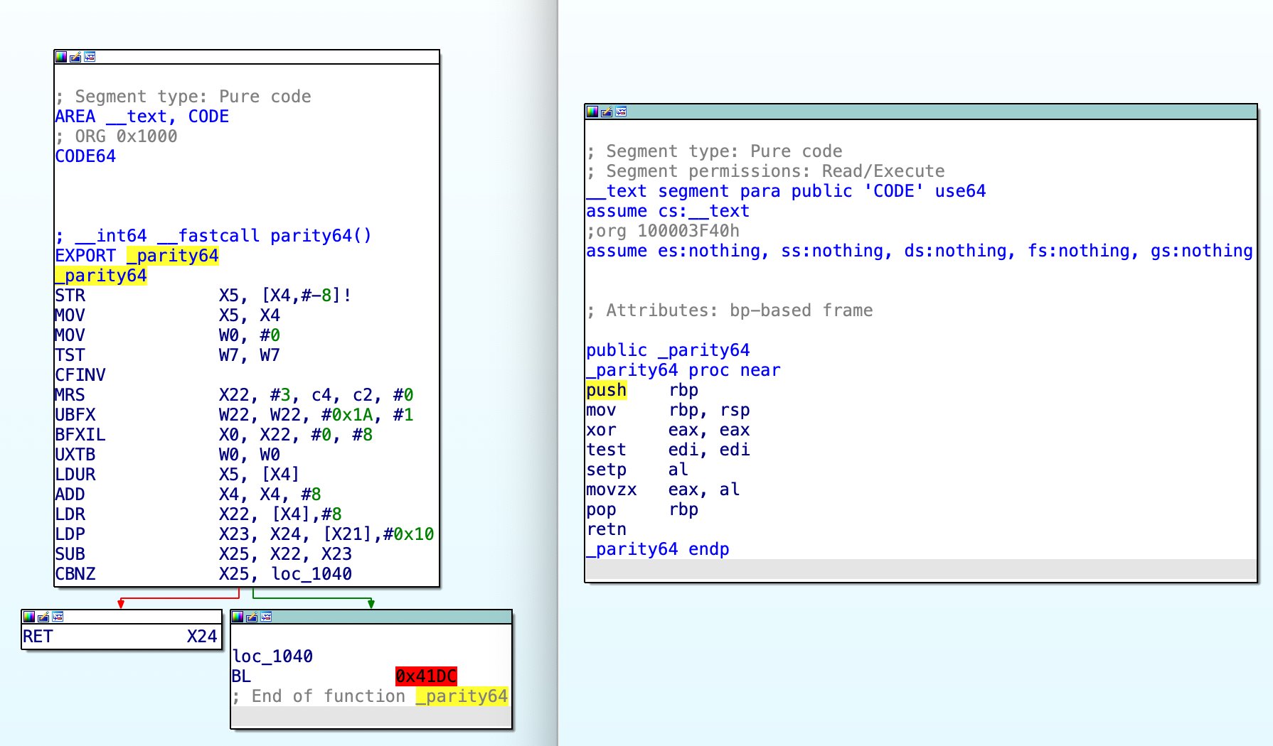

I think a fruitful example of the sort of thing that might improve RISC-V emulation is this hack Apple made to the ARM ISA, in order to facilitate faster x86 emulation:
