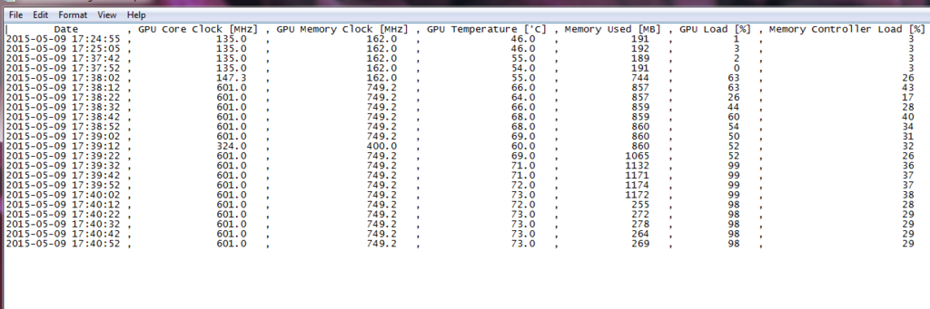

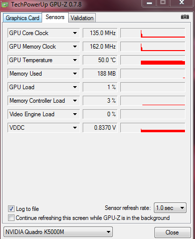

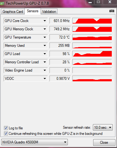

I haven't had any problems in the past with my GPU until just recently. After around 30 minutes playing any game it starts lagging so bad, that it's unplayable. restarting the game doesn't do anything and it continues to lag. I downloaded GPU-Z and I noticed that my GPU load before the lag spike goes from around 3-5%, to 98-99% and stays there. The only "solution" that I've found is to restart my entire computer. And then 30 minutes later the same things happens. Also the GPU temp. goes from around 50 degrees Celsius to around 70 degrees.

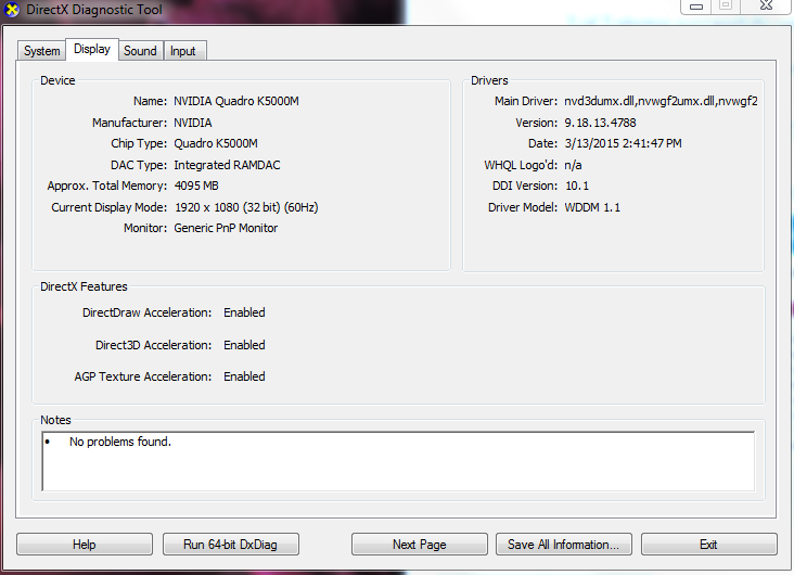

Dxdiag and GPU-Z links below:
GPU-Z before lag spike while playing Skyrim: http://i1318.photobucket.com/albums/t650/cowpower2011/GPUZ%201_zpslqecenpl.png
GPU-Z after lag spike while playing Skyrim: http://i1318.photobucket.com/albums/t650/cowpower2011/GPUZ%202_zpspnsegxf9.png
GPU-Z sensor log:
http://i1318.photobucket.com/albums/t650/cowpower2011/GPU-Z%20Sensor%20Log_zpsljpv3cws.png
DxDiag:
http://i1318.photobucket.com/albums/t650/cowpower2011/dxdiag_zpsf1if0riz.png

Actually it turned out that there was a hidden bitcoin miner.
When the GPU usage drops like that, that usually means something has taken use of the CPU, or the CPU has throttled badly due to heat. This is usually not a sign of a GPU problem, but something else. Check for viruses, check your CPU temps, see that you don't have some background app running that saves data every 30 mins, or does a scan of some sort.
