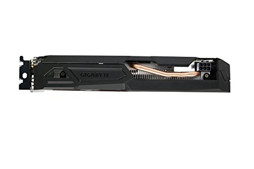

Well, of course it is compatible with motherboard. But no matter what you read on Amazon, if this is your card: https://www.gigabyte.com/Graphics-Card/GV-N105TWF2OC-4GD#kf
then it clearly states it needs a 6-pin power: https://www.gigabyte.com/Graphics-Card/GV-N105TWF2OC-4GD#sp
Power Connectors 6 pin*1
and a picture showing a 6-pin header:
So, what brand and model your PSU is?
