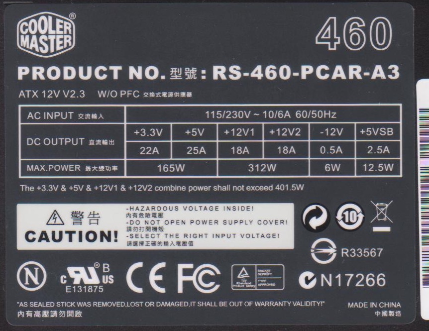

My previous power supply, the one got overheated was Cooler Master RS-460-PCAR-A3 460W.
My new power supply is Huntkey Jumper 500
Im posting this two pictures because i don't know how to read them. i want to know whether my new power supply is sufficient to support my graphic card or not.

The simplest way would be install your GPU in another computer and see if it behaves the same way. That or if you know someone that has a GPU you could borrow to install in your rig and see if it works correctly.
I normally only recommend using PSUs made/sold by reputable companies such as Seasonic, XFX, Corsair or Antec (maybe a few others). I have never heard of your new PSU manufacturer, so I cannot vouch for it's operation, or even if it can operate at the continuous power levels required in gaming situations. Many cheaper, no-name PSUs may say that they are a 500W PSU, but that is the peak power they can deliver, not the continuous amount of power they can deliver. However, it may be the new PSU is capable and that your GPU was damaged when the PSU was, either by the same excessive heat that took out the PSU or by your original PSU dying, causing it to damage the GPU.
