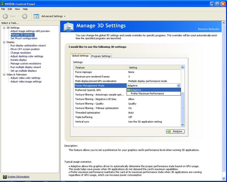

Have you tried going into Nvidia Control panel and changing the power setting to performance over normal? I've seen Nvidia cards have issues with voltage on low usage apps and causing system crashes. The downside is your card will always run a full speed, so temps will run a little hotter since the clock speeds won't go down when in idle usage.

EDIT NO.2 BECAUSE IM STUPID: When you talk about setting it to change power setting to performance, you are referring to the setting in "Global Settings">"Power Management Mode"?
Correct.
