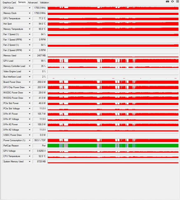

So this is the issue that using cooling which does not cover all heat generating points of the GPU, which are usually covered by 1) factory air coolers and heatsinks or 2) full-cover GPU blocks.
AIOs which use the G12 don't always account for the vRAM, Mosfets and other hot points on these cards because the AIO only covers the GPU die while leaving other components exposed. This is similar to universal waterblocks that can be installed - secondary cooling is needed for the other components on the card. I've never used a G12, but I know how they work, most of which is to offer the support for an AIO to cool the GPU die...the rest is supposedly cooled by the included fan.

Just ran heaven, and took some snips from the sensor page.
From the Card pane:
It peaked at 95,1 degrees during the second-last scene. That's.. rather immense.

Not sure if undervolting the gpu would get the temps down enough.
And TH done a review of your case and Sorry to say this but the case isn't helping matters either.
https://www.tomshardware.com/review...0c-atx-full-mid-tower-gaming-case,4415-2.html
Yeah, it ain't a great case. I thought it was fine at the time, but that was different, older, hardware.
I tried undervolting a bit, and it does make a difference. Still doesn't feel like safe temps, though.
What cooling options do I have, aside from changing the case?
Aug 9, 2021
Only other alternative I see is drilling/cutting a hole in the see-through case to mount some fans there for more airflow, but I think that'd just crack the entire side panel?
