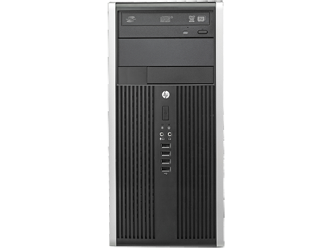

Hey everybody!
here are my pc specs:
hp elite 8200 microtower
intel core i5 2320 3.0-3.3ghz
2x4 ddr3 8gb ram
gt 630 2gb 128bit
hp 320w psu
here is the pic of my cpu
http://h10003.www1.hp.com/digmedialib/prodimg/lowres/c02865956.png
pic of mobo
http://hexparts.com/assets/images/prodimages/611834-001.jpg
i am buying a new gtx 750ti 2gb or gtx 1050 2gb
i want to know that can i put my graphics card into the second pci-e x16 slot?(black)Because there is not enough space after the first slot (white)would be there any downfall of speed?will my psu handle these graphic cards?my current graphics card is in the first white slot..
sorry for my bad English!any help would be highly appreciated.please reply
