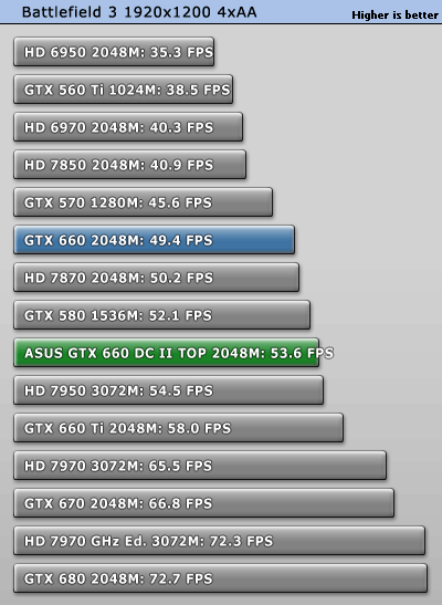

4XAA you will have problem reaching 60 FPS(this is single player, in multiplayer it is even lower because CPU bottleneck on high player count maps), 0XAA though you should be fine, Techpowerup uses a different set up than Tom's so the FPS is not cross comparable:
Highly recommend getting a factory OCed 660, like the MSI GTX 660 TFIII/ASUS DC2 Top/Gigabyte OC
