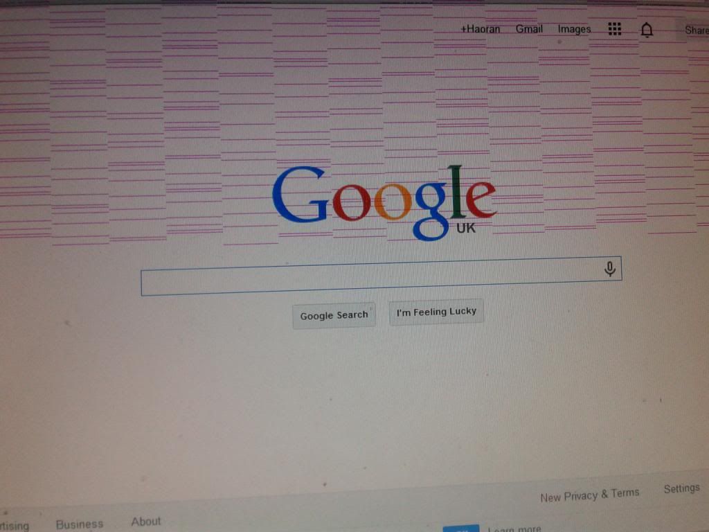

So, I just got the latest Geforce Experience and decided to play BF4 since the new DLC is out.
The game ran perfectly normal for around 15min the suddenly the computer resets. When it loaded up windows there was pink(sometimes blue or green) horizontal lines in segments across the screen. The computer also reset a few times.
Also it no longer detects my main monitor(1080p HDMI) only my second VGA monitor.
I then reinstalled the card and drivers to no effect. I swapped out the card for an old HD 4350 and everything worked fine with both monitors.
So I conclude the issue to be the GPU it self.
The card is Palit Super Jetstream GTX 780 @ stock, bought new 2 months ago from Scan.

Ok, so uninstalled all things Nvidia and clean reinstalled drivers(331.82 & 331.93) and Geforce experience still does nothing. Its strange that Geforce experience and Nvidia control panel does not recognise the 780, GPUZ does recognise the card but under pixel filter rate, texture filter rate, memory type, bus width and bandwidth is listed as "UNKNOWN". Also All clocks are show as 0Mhz and no ticks in any of the computing boxes.

Went one better and tried in my flat mate's PC. Same thing. 99% sure is a GPU failure, gonna contact Scan just now.
