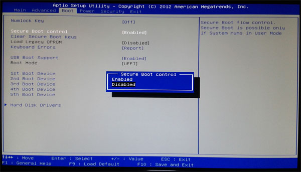

So, you need to disable Secure Boot in BIOS.
Open BIOS, go to BOOT page and disable Secure BOOT, so boot up with Secure Boot DISABLED, Boot Mode: EUFI.
Report back ASAP.
Do not change UEFI to LEGACY.
First I need to know if you have UEFI BIOS or Legacy. Check this link to find out http://www.eightforums.com/tutorials/29504-bios-mode-see-if-windows-boot-uefi-legacy-mode.html
If you have UEFI BIOS, next will explain how to Disable Secure Boot.
Trying to find pictures to help
Go to BIOS SETUP as highlighted line, it should be there.
Next you see this
You need to have the same Secure Boot Control - DISABLED.
I think this is how you do it
But I don't know how to get there, once you find this window, just disable Secure Boot, SAVE and EXIT to BIOS.
