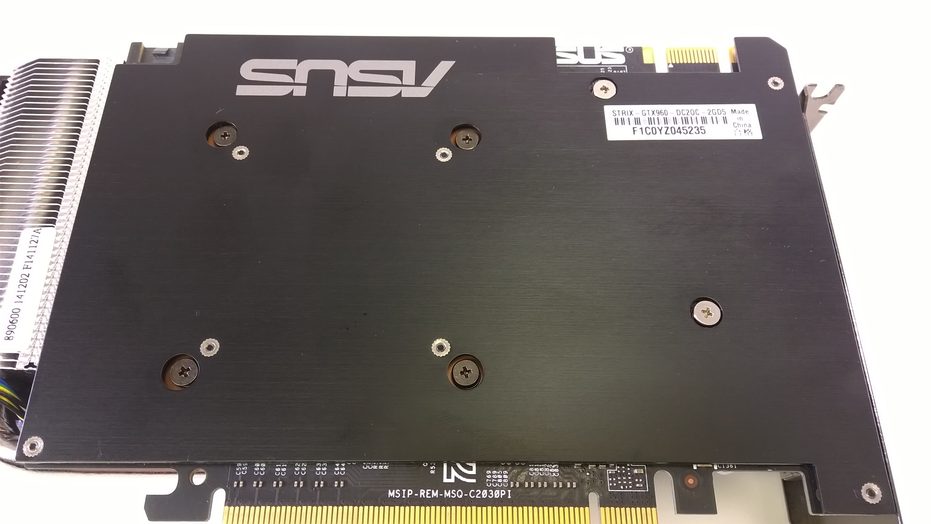

Hello. I am willing to do a pc mounted on a wall project and i have an idea to attach this gpu horizantally using longer backplate screws. But the problem is that i do not know what size they are. Can anyone help me ?
This is how screws look like from the back.
Thank You for all the support I may receive.
Maybe take one out and measure it. At a guess they will be 3 or 4mm diameter screws.
Anyway, what I'm really replying about is to let you know those 4 darker screws that form a square are not something you want to mount to. They have springs on them and keep the cooler held down onto the GPU with the correct tension....don't go removing them.
Oh i see. Then i need to figure out another way to mount it. Thank You.
