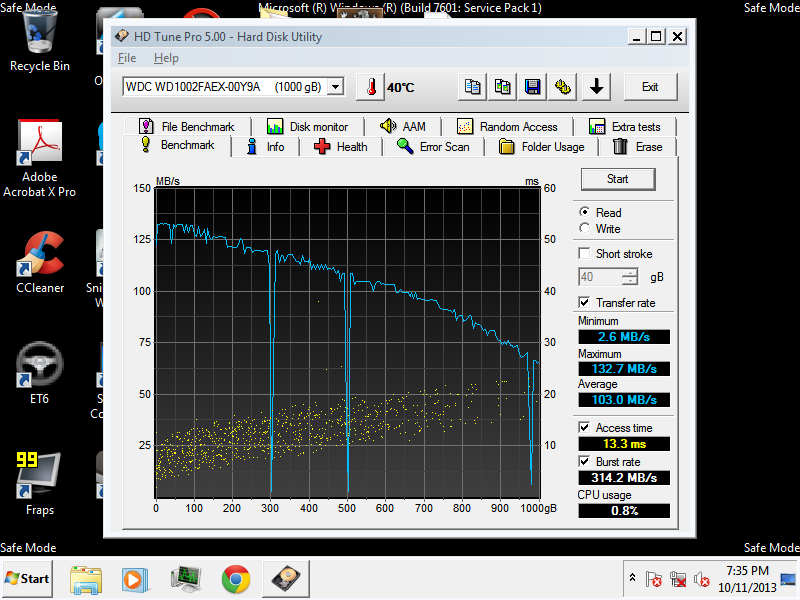

Hi everyone!
I been having a problem with my 1TB Western Digital Caviar black. one thing i notice is that even when opening a browser or new tab or even some application a eventually get a lag spike so i tried running hd tune and i get a very low minimum read speed. I also tried running on safe mode with no background process and the result is the same. Please take a look at here http://i973.photobucket.com/albums/ae219/balasubas111/benchmark_zps3e787dfc.png

Already defrag and scan my disk and there is no bad sector.
Hi,
I had the same problems today - the problem was the cable not the hdd - i have 3 hdd's installed so i played around with the cables and average went up 50mb/s ,minimum transfer also went up.
I would also check and remove hdd shutdown from power-saving options - sometimes it goes buggy and shuts the hdd for no reason - should be on never.
you can check on some hd utility if crc error count goes up all the time - usually means a faulty cable or usb port.
GL
