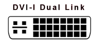

Okay, what you're trying to do will not work. HDMI is digital where VGA is entirely analogue. There are three different kinds of DVI. DVI-I, DVI-D, and DVI-A.
DVI-I and DVI-A have three rows of pins and a spade connector to the right side with two pins above and below the spade. DVI-D lacks the pins above and below the spade. DVI-I has the necessary connections to cover both analogue and digital connections.
VGA is being more aggressively phased out nowadays so most GPUs won't come with a VGA port, instead having a DVI-I port in which you need to use a DVI-I to VGA adapter. You can not go from HDMI to VGA through DVI adapters. Not without a powered translation box. I would generally not recommend HDMI to VGA converters that are too cheap because honestly, they'll stop working sooner rather than later. You do get what you pay for.

A DVI-I socket will take DVI-D or DVI-A. It has the necessary pins to work both HDMI and VGA. A DVI-A or DVI-D cable will fit into a DVI-I socket. If both your DVI sockets are DVI-D then you can't go to VGA, again not without a powered converter box.

Okay, DVI-I can give out and take in both analogue and digital signals. So DVI-I can be adapted to either VGA or HDMI. DVI-D will only work with HDMI and DVI-A will only work with VGA. I wouldn't worry about dual links at the moment. The only thing you need to know is that DVI-D cannot be used with VGA. If your GPU has DVI-D and HDMI and VGA, you can either have one analogue screen or two digital screens.
