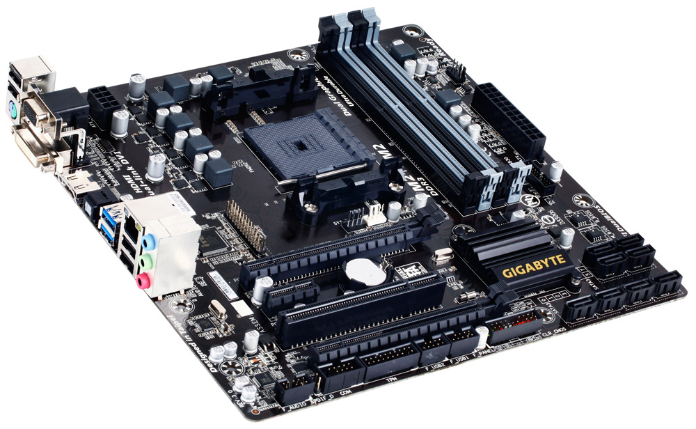

Basically, i do not recommend using a same fan headers for different fans, even its the same configuration. But if you have no other fan headers, then i would say you can go with splitter. Though it's fine at all.
Otherwise, if you only have one fan header on your motherboard which its rarely found on new boards except for mini-ITX boards, then go for 4 heatpipes and one fan because it has better looking cooler for its price, IMO.
