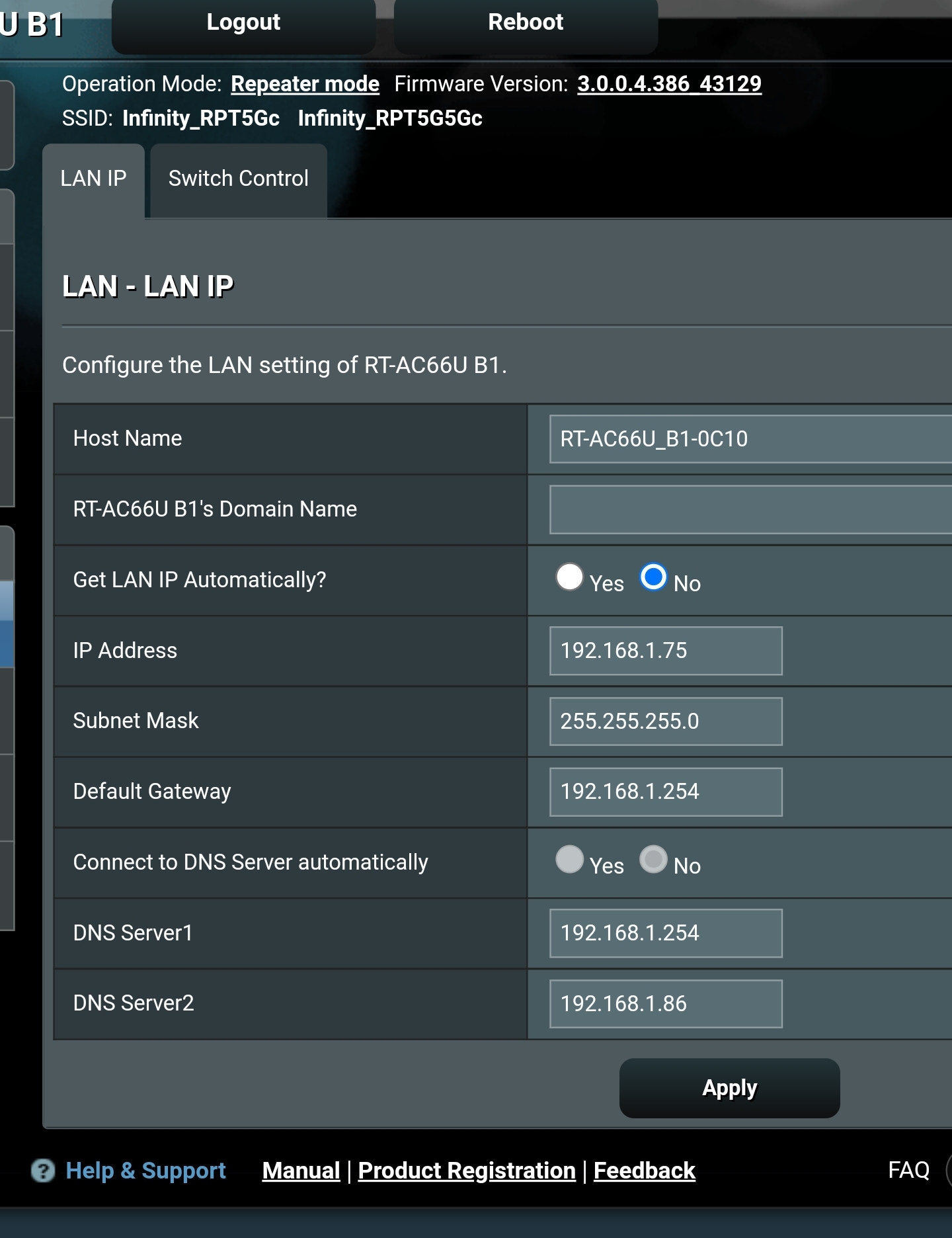

I tested the network coverage of the ac86u close to the modem to see if I can get enough speed on the ac66u, unfortunately the signal was too weak to let the ac86u there and plug the ethernet cable on the modem to transform the ac86u into a roiter.
So I tried again to connect the ac66u to the ac86u both as repeaters, this time using static ip.... It kinda worked
I mean Lan could get full speed of 125mb/s, the repeated 5g 65mb/s... But the new 2.4 ssid didn't get Internet, go figures!!
About dns1 and dns2 of the ac66u static ip, I set 8.8.8.8 and 192.168.1.254 which is the ips of the modem
There is definitely something wrong
Here the static ip settings I used:
Provided that I have followed correctly, you set up the AC66u with a static IP of 192.168.1.75
However, the default Gateway should be the AC86c router (as a router and not as a repeater) at 192.168.1.1 if that is indeed the IP address that the router is set at.
The modem (with its' router/DHCP functions disabled) does not need an IP address from your network router.
