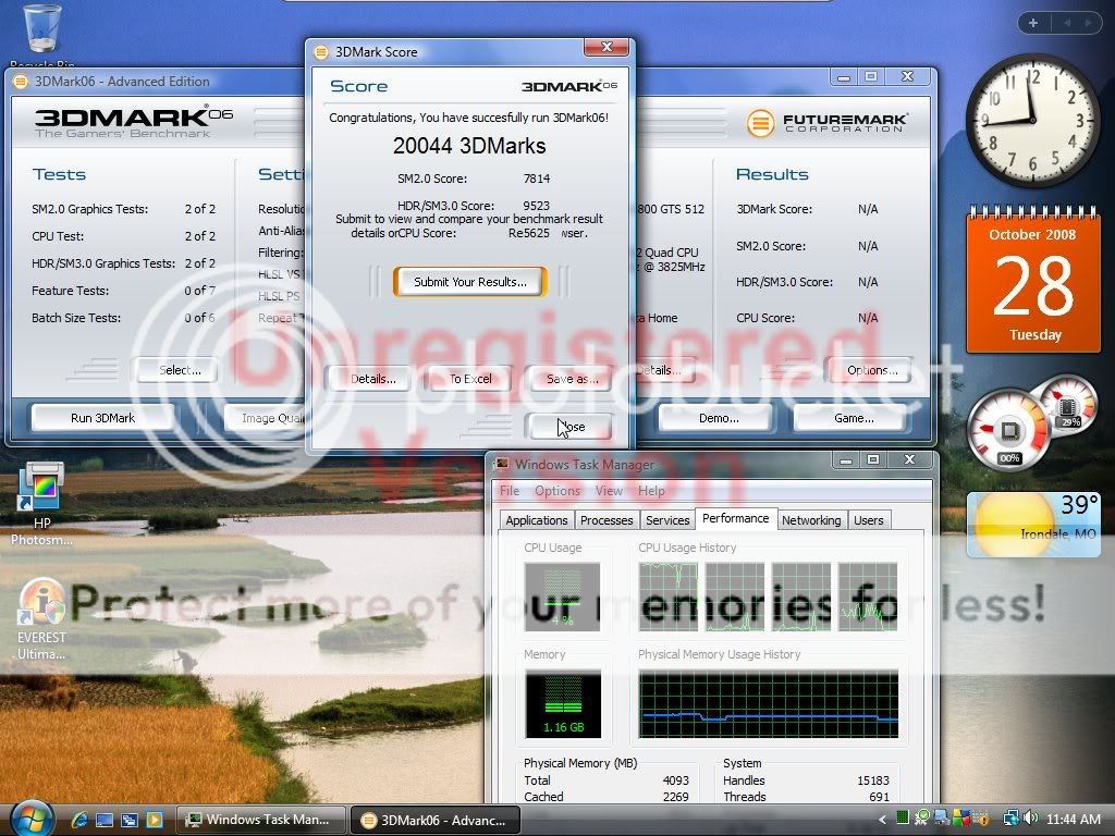

Okay. I want you to know that I do water cool but these processors will run @ 3.8 on air if you can keep them cool enough.
You should read and learn enough about OC'n to start making some adjustments on your own. Then if you are having problems and some one should ask you what Vtt and NB voltages you are running you would know what they are talking about. :)
I currently am running a EO CPU but had a C1 before this.
Hope this screen shot helps.
Good luck and happy OC'n.:)
Thought I should explain why the temps reported in the "LOW" category are so high. I forgot to open Core Temp when I started P95 so when I did open it those were the temps recorded at that time.
Idle temps are currently being reported as 25, 29, 36 and 16 but I have several programs running which represent my typical operating temps for this work load.
