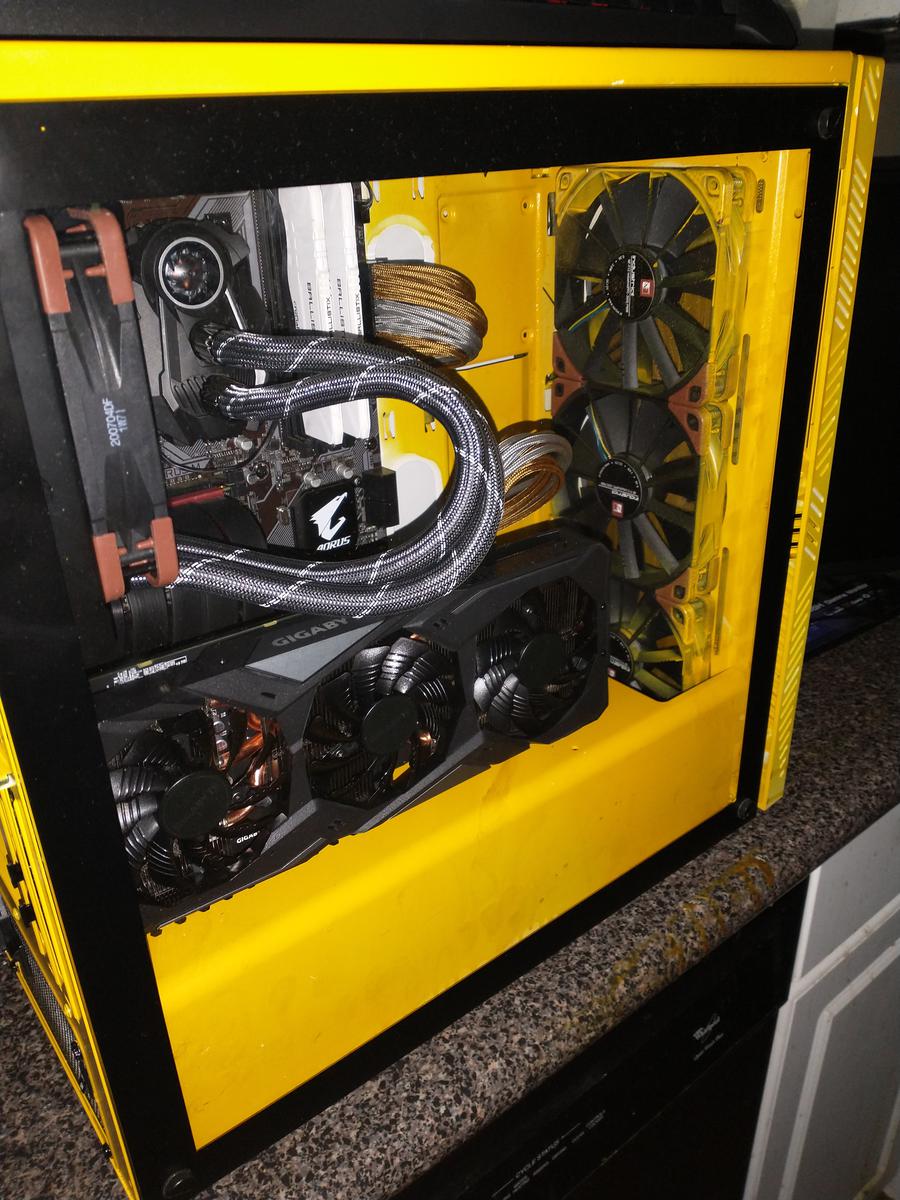

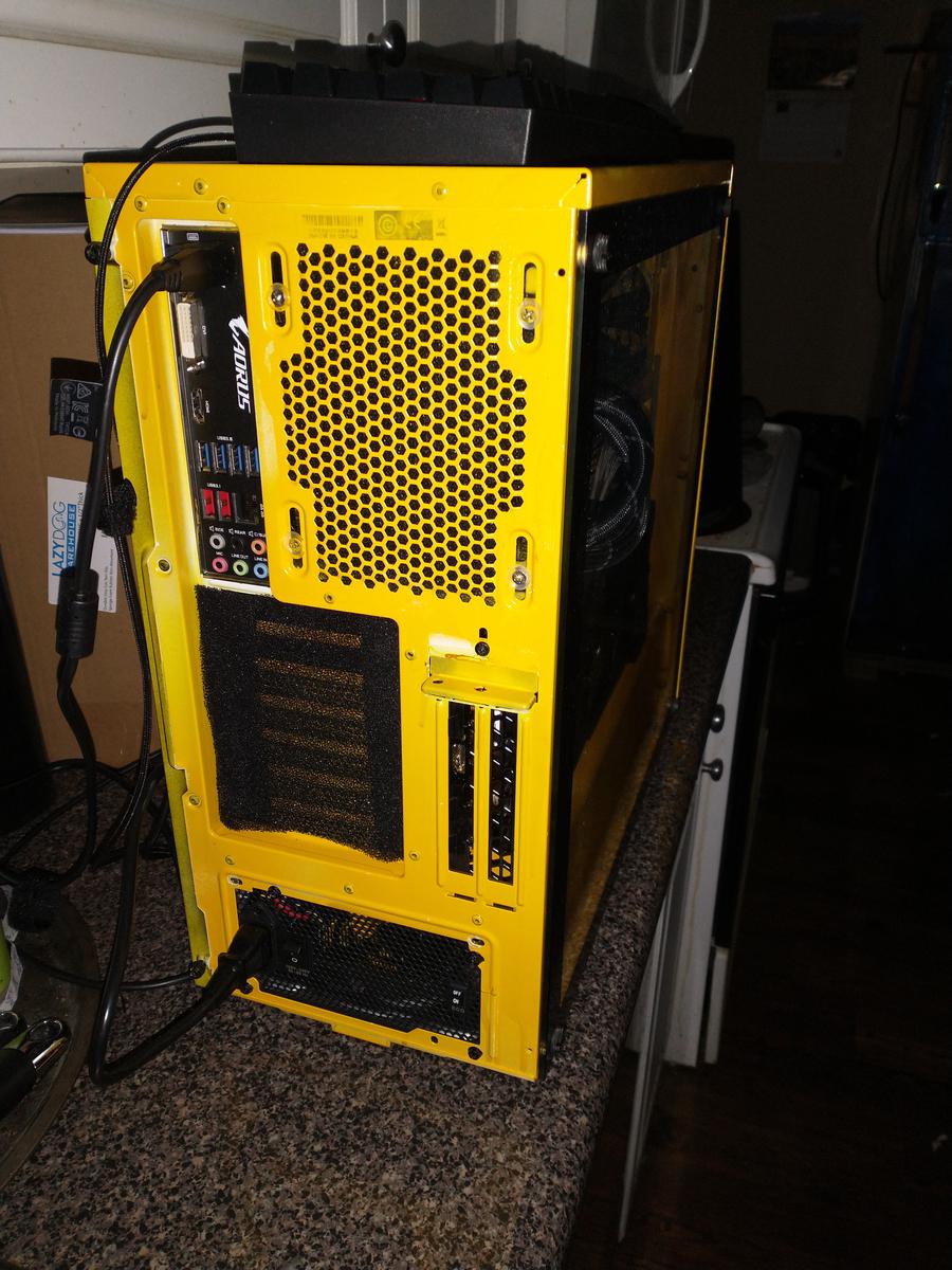

im finishing my first ryzen build an need some advice
my setup is the b450 aorus m + ryzen 5 2600 with 32gb of Crucial Ballistix 16 GB (2 x 8 GB) DDR4-3200 CL16 Memory 2nd set yet to be installed
but after boot up i cant seem to change the setting in bios when i click on auto to go manual it dosent do anything ,i recently saw a youtube where somone showed that clicking on the desired values to change an just type them in an hit enter, can you advise an confirm this iv yet to try
an if it does work whats the best oc clock an voltage to push to 3.7ghz
im using
a ARCTIC Liquid Freezer II 120
an Innovation Cooling Graphite Thermal Pad – Alternative to Thermal Paste/Grease (40 X 40mm
an a Noctua NF-F12 iPPC 3000 PWM in the pull config with two Noctua NF-A14 iPPC-3000 PWM as top exhast to my corsair 275R Airflow case
but i cant seem to change the setting in bios clicking on auto to go manual dont do anything ,i recently saw a youtube where somone showed that clicking on the desired values to change an just type them in can you advise an confirm this iv yet to try
im using
an to any who can advise me on further bios setting that im using ,should be using or not or havent used that i should be please forgive the not spartin screen shots
https://photos.google.com/share/AF1...?key=NmFFY25QbWVxRmlkaUxuYWwtblVPMHJZVmJyaER3
The B450 m is not an overclocking motherboard...it has a relatively weak VRM and if pushed too hard without active cooling directly on the VRM it may thermal throttle your cpu.
You'll likely get just as good results by simply running with PBO on, focusing on tightening your ram timings as tight as possible, and improving your CPU cooling since a 120mm AIO isn't really up to overclocking either.
I never use the mouse in BIOS. I have a similar B450 board, actually a weaker version of the gigabyte. Use the arrow keys on the keyboard to select what you want, then use +/- keys to increase or decrease parameter. Don't worry about the weak VRMs. Ryzen always reaches the silicon limit before you reach VRM limit when overclocking. Burning VRMs was a problem with older AMD platforms, not Ryzen. You can direct a fan over them if you don't like them heating up so much.
As far as your 120mm AIO, you'll have to try and see how it performs. You might just need to run your radiator fan a bit harder. When it comes to the chips of today (CPU or GPU) it's getting the heat from the silicon to the cold plate which is always the limiting factor because of how dense transistors are packed in nowadays. A larger radiator will keep coolant cooler, but the general formula is that you want 120mm of radiator for every 100w of TDP, meaning that you should be alright for that CPU even when overclocked.
